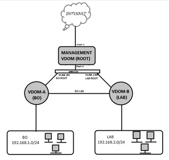

Topology :
VDOMs can communicate among themselves via VDOM connections instead of extra physical interfaces.
The communication between VDOMs is known as inter-VDOM routing. Virtual interfaces known as VDOM linkages link together VDOMs. A pair of interfaces that are each linked to a VDOM and serve as either end of the inter-VDOM connection make up a VDOM link.

Configure the physical interfaces:
Next, configure the physical interfaces. This example uses three interfaces on the FortiGate unit: port2 (internal), and port1 (external). Port2 interface and VLAN is a department’s network connected. Port1 is for all traffic to and from the Internet and uses DHCP to configure its IP address, which is common with many ISPs.
