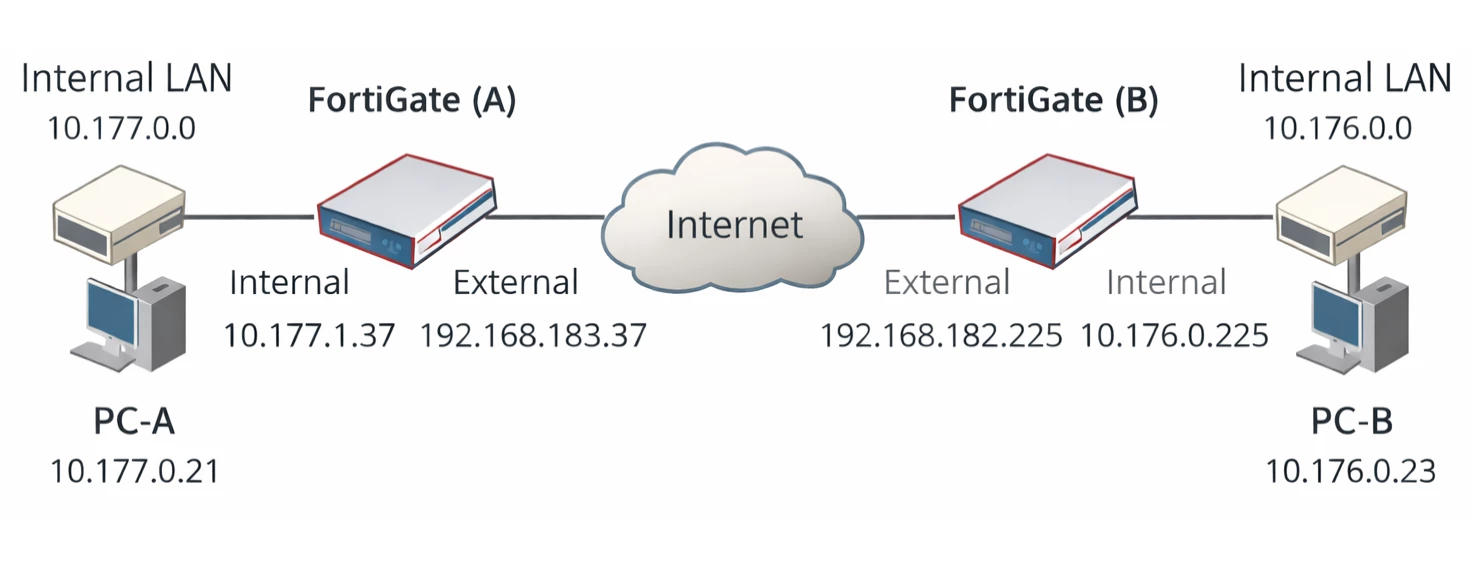

Description This article describes routing issues when some traffic is not using the routing table.
Scope FortiGate.
When the system works as expected, the routing table will look like the following output.
get router info routing-table all
Codes: K - kernel, C - connected, S - static, R - RIP, B - BGP
       O - OSPF, IA - OSPF inter area
       N1 - OSPF NSSA external type 1, N2 - OSPF NSSA external type 2
       E1 - OSPF external type 1, E2 - OSPF external type 2
       i - IS-IS, L1 - IS-IS level-1, L2 - IS-IS level-2, ia - IS-IS inter area
       * - candidate default
S*       0.0.0.0/0 [10/0] via 192.168.183.254, port2
S       10.0.0.0/8 [10/0] via 192.168.183.254, port2
S       10.176.0.0/23 [10/0] is directly connected, to3600
C       10.177.0.0/23 is directly connected, port1
C       192.168.182.0/23 is directly connected, port2
Ping between PC-A and PC-B, and run the below debug:
