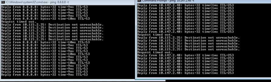

Below snip is continuous ping during a failover:
Route after failure:
S*      0.0.0.0/0 [101/0] via 10.169.2.67, port4                             <----- internet and branch traffic both now use this.
Notice, there is no more specific route for 10.147.0.0 network, also there were few drops.

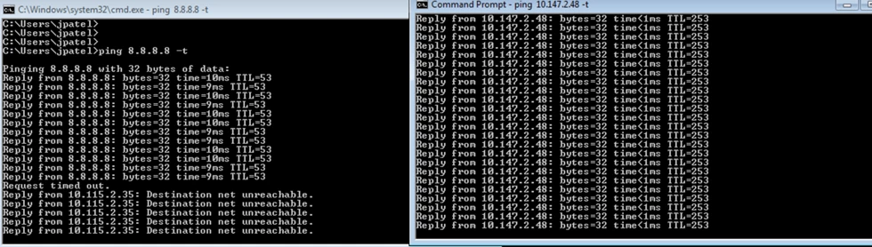

Now compare the new pings and the route after a failover, the ping to internet dropped but the ping to the branch did not drop.
S       10.147.0.0/22 [10/0] via 10.129.2.67, port3
Both the routes are present, Branch is going through port3 and internet is going through port4
