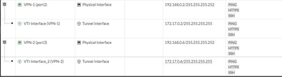

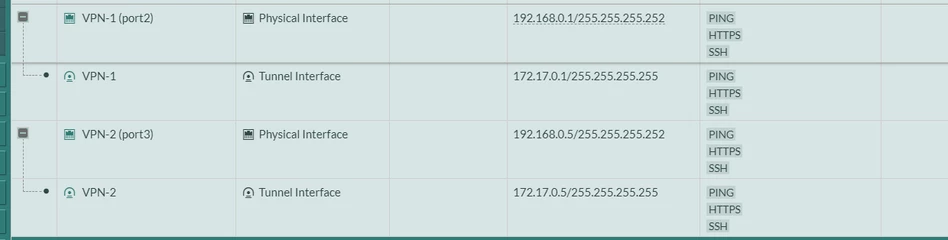

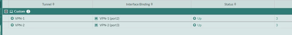

  • Configure IPSec Site to Site VPN redundant tunnel for both sites:
  • Assign Tunnel Interface IP for both Sites Tunnel.
Site-1:
Site-2:

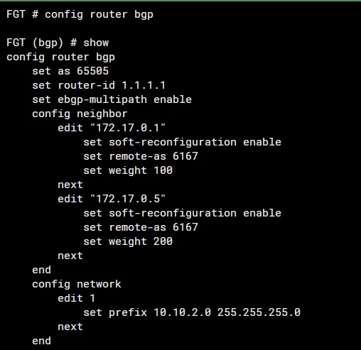

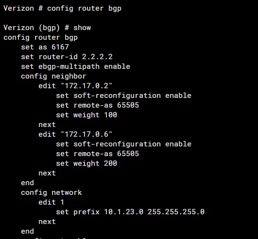

  • Configure BGP on both Sites.
  • Set weight for neighbors as required.
Site-1:
Site-2:

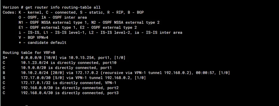

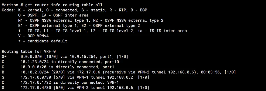

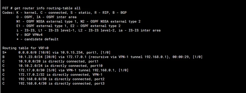

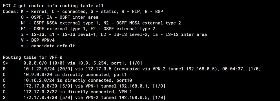

  • Check the routing table. VPN Tunnel with higher weight BGP neighbor will get priority.
Site-1:
  • VPN-2 is active in the routing table as the neighbor weight is higher:
Site-2:
  • When Tunnel VPN-2 goes down traffic will be forwarded using Tunnel VPN-1.
