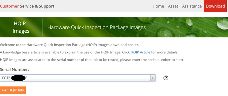

Go to Download -> HQIP Images and enter the serial number of the unit.
If the HQIP test image is not available for the unit, check first if the unit has the test bench included in the FortiOS.
Then, if the test is not available, contact TAC Support in order to be provided with the correct HQIP image.

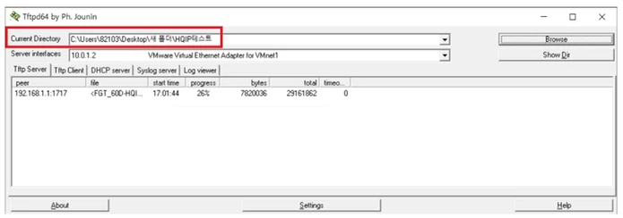

  2. Run the TFTP server and configure the 'Current Directory' field where the HQIP image is located.
