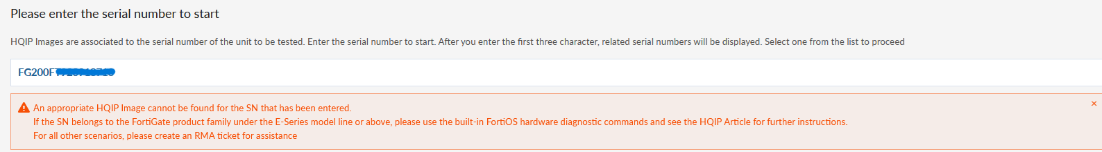

Traditionally, hardware diagnostics require users to download the HQIP image and then load the image on the device before the tests can be performed. Starting in FortiOS v5.4 with FortiGate E-Series models, HQIP tests are built into FortiOS itself. This allows users the convenience of performing hardware diagnostics without needing to find the HQIP image and reload the firmware image.
No HQIP images will be produced for FortiGate E-Series and above that support built-in HQIP commands. When trying to download one of these types of models, the following error will be displayed: 'An appropriate HQIP Image cannot be found for the SN that has been entered.'.
