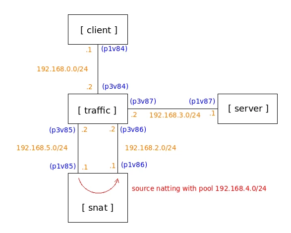

The following setup is used in the test scenario.

The following examples are provided to highlight the "strict-src-check" setting.
These examples use several VDOMs of the FortiGate. Port1 and Port3 are connected with a cross-over cable for inter-vdom communication.
Test traffic :
A telnet is issued from the VDOM client to the VDOM server IP address (192.168.3.1).
The flow is diverted by a policy route on VDOM 'traffic' toward the VDOM 'snat' where the packet is source-natted with an IP pool (192.168.5.1-10).
The packet is re-injected in 'traffic' VDOM with a source IP address of 192.168.5.x.
Flow :
  • The packet leaves client VDOM as '192.168.0.1 -> 192.168.3.1'.
  • The packet flows in VDOM 'traffic' from the interface (p3v84) to (p3v85) and reaches the VDOM 'snat'.
  • The packet is source-natted in VDOM 'snat' and re-injected to VDOM 'traffic'. The packet is now like 192.168.5.X -> 192.168.3.1
  • RPF takes place in VDOM 'traffic'.

  1. VDOM traffic configured with 'strict-src-check disable' with a second non-priority route.
In this scenario, 2 routes for 192.168.4.0/24 exist :
  • The preferred one has priority 0 (default). This is the one used for routing and points to a different direction than the one the packet ingress from.
  • The second one has priority 10 (less preferred), not used for routing because a similar route with a lower priority number exists. It points to the interface where our packet comes from. This is the one that neutralizes the RPF filter for the source natted packet.

Connection is OK:
FG3K8A-4 (client) # execute telnet 192.168.3.1
FG3K8A-4 login:
Flow shows packets transmitted :

Now, if enabling strict-src-check, RPF drops the packet :
Configuration :
FG3K8A-4 (traffic) # config system settings
FG3K8A-4 (settings) # set strict-src-check enable
FG3K8A-4 (settings) # end
Flow showing packet is dropped:

id=36871 trace_id=178 func=ip_route_input_slow line=1287 msg="reverse path check fail(by strict-src-check),drop"
Reverse path Forwarding failure drops counter:
Below CLI command has a new counter to track and check packet drops due to RPF failures, and is available in FortiOS v7.6 & later versions.
