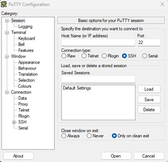

The above image shows the default view after opening PuTTY.
The default connection mode is SSH.
The IP must be entered in the 'Host Name (or IP address)' field.
Afterwards, select 'Open' to start the session.

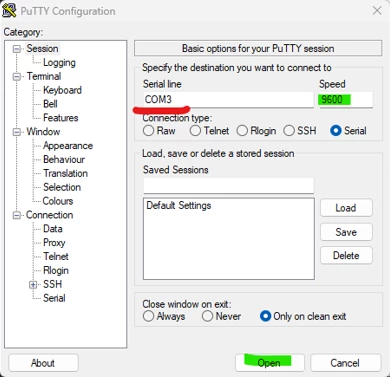

For console serial access, the COM port number is required.
To find out the COM port number on Windows OS, perform the following steps:
  • Windows Key + R.
  • Enter 'devmgmt.msc' then select 'OK.
  • Scroll to the section 'Ports (COM & LPT)'.
  • Retrieve the COM port number.
  • It is 3 in this example.
Once the COM port number is known, select 'Serial' and then change the 'Serial line' value if necessary to the value found out previously. Run the connection by selecting 'Open'.
Connection speed should not be changed as 9600 is the appropriate value to access the FortiGate console.

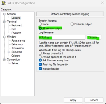

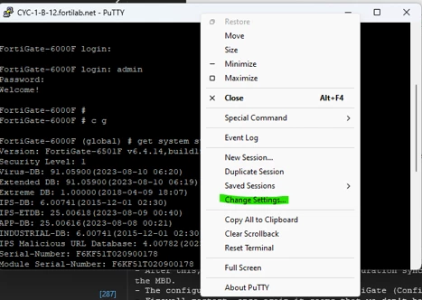

Console output can be saved in a text file if required. It is usually recommended to have a backup of the operation as a text file.
To do so, 'right-click' on the title bar and select 'Change Settings'. Go to logging and then select 'All session output' and the target file.

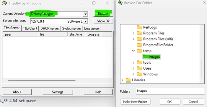

If a firmware upgrade is required for the operation, the technician should have a TFTP server ready to serve a firmware image to the FortiGate.
The Tftpd64 application will accomplish this.
To download the application, go to the GitHub page and select 'Download page'.
Choose either 'tftpd64…exe' or 'tftpd32…exe' and install it.
After that, create the 'C:\temp\images' directory and 'Browse' in the application to select the new directory. This will be the root directory of the TFTP server.
All images and configurations that should be uploaded to the FortiGate should be in the TFTP root directory folder.

it should be mentioned some hardware (at least the ones I’ve worked with) require the image to be specifically called ‘image.out’
