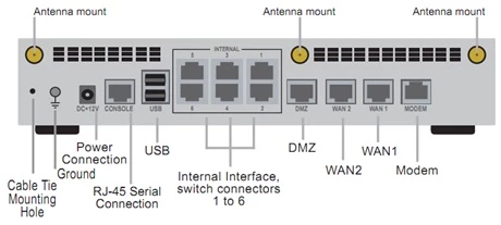

FortiWiFi 80CM interface:

It's now time to begin the configuration of the VLANs. Please note that I've written this guide with this particular configuration in mind :
  • WAN1 of the FW80CM will be connected to the BTU
  • DMZ of the FW80CM will be connected to the IPTV STB
  • LAN port 1~6 of the FW80CM will be connected to your PC & network device
  • WiFi of the FW80CM for Laptop with WiFi capable

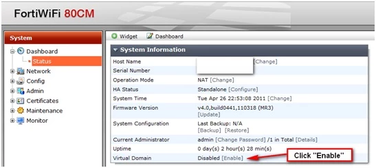

1)      Enable VDOM (Virtual Domain) via System Status

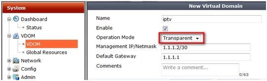

2)      Go to System > VDOM > VDOM, create a new VDOM “iptv”
- make sure Operation Mode is “Transparent”, configure dummy IP for Management IP & Default Gateway

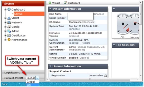

4)      Switch current VDOM to “iptv”:
