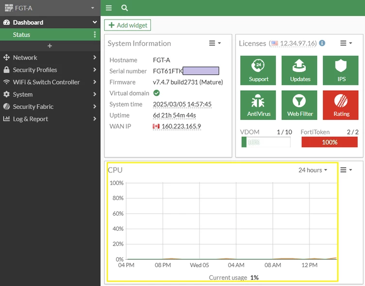

If CPU usage was generally at acceptable levels during busy periods (for example below 60%), disable Content Processor acceleration for IPS.

To disable IPS Content Processor acceleration, make the following configuration change during a less busy time. Since this restarts ipsengine, change should be done after hours unless production traffic is already degraded.
config ips global
set cp-accel-mode none
