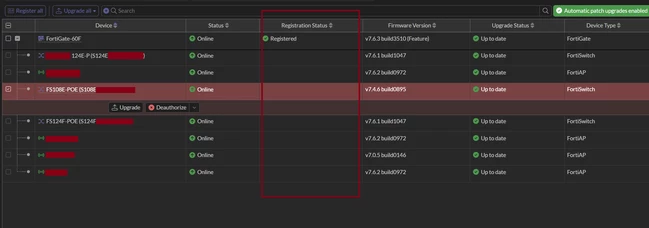

Description This article describes the behavior in FortiGate GUI when the registration status of the managed devices shows empty.
Scope FortiGate v7.6.3.
When the FortiGate is on 7.6.3 version or is upgraded to 7.6.3 version, upon checking the registration status of the managed devices like FortiAPs and FortiSwitches from FortiGate GUI under System -> Firmware & registration, it shows empty as shown below:
And when trying to register these devices from the FortiGate and doing the debugs, it shows the device is already registered.

The output with the debugs on shows something like this:
[113] fds_print_msg: <?xml version="1.0" encoding="utf-8"?><soap:Envelope xmlns:soap="http://www.w3.org/2003/05/soap-envelope" xmlns:xsi="http://www.w3.org/2001/XMLSchema-instanc
e" xmlns:xsd="http://www.w3.org/2001/XMLSchema"><soap:Body><ProductRegistrationForNonFGTResponse xmlns="http://tempuri.org/"><ProductRegistrationForNonFGTResult><RegistrationResp
onse xmlns=""><Version>3.0</Version><Result>error</Result><Error>"S124DP3X15000000" has already been registered.</Error></RegistrationResponse></ProductRegistrationForNonFGTResu
[105] fds_print_msg: lt></ProductRegistrationForNonFGTResponse></soap:Body></soap:Envelope>
[563] fds_send_reply2: Sending 582 bytes data, data2len=0.
[507] fds_free_tsk: cmd=29; req.noreply=1
========Forticare response error========
Registration failed
Upon verifying the same in the FortiCloud portal under Products -> My asset, the device shows as registered.
This is a cosmetic or GUI known issue in FortiOS v7.6.3 version and is fixed in version v7.6.4.
