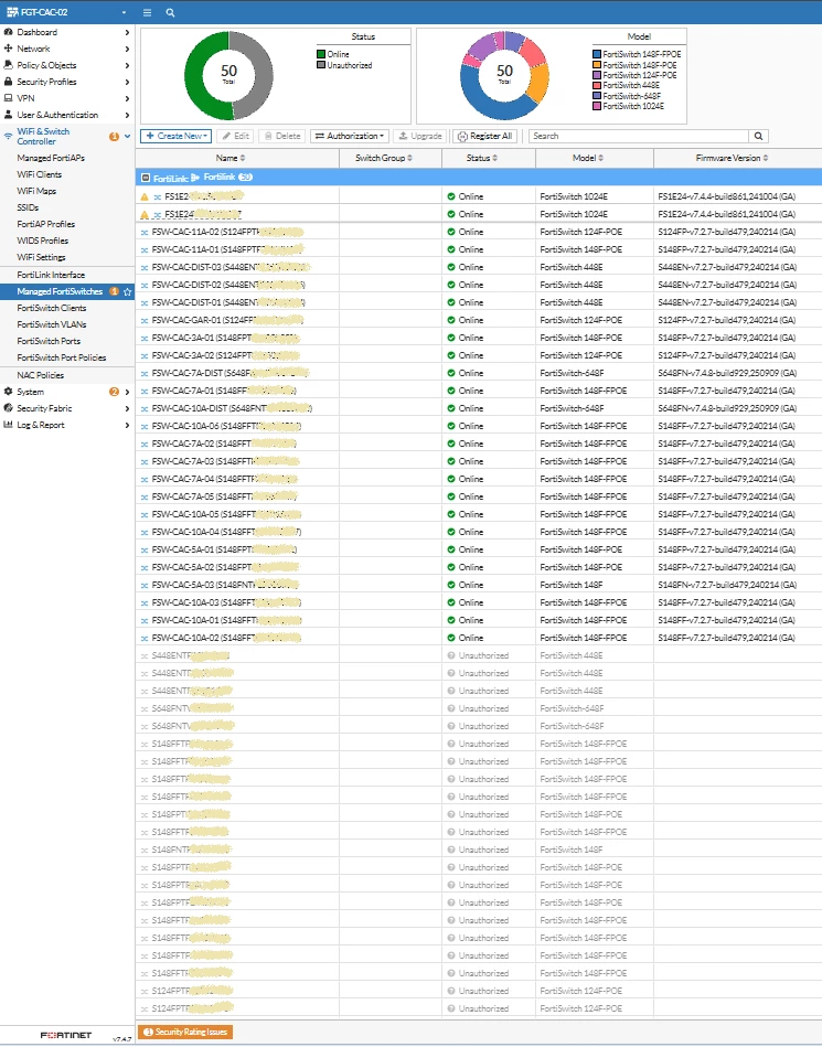

Description This article describes an issue observed on FortiGate devices running v 7.4.7 and v7.4.8, where duplicate FortiSwitch entries appear in the Managed FortiSwitches section after transitioning from standalone mode to HA Active-Passive mode.
Scope FortiGate v7.4.
After transitioning a FortiGate from standalone mode to HA (Active-Passive) mode, duplicate FortiSwitch entries may appear in the Managed FortiSwitches section. Each switch may be listed twice (once with its hostname and once with only its serial number). This is a known issue in FortiOS v7.4.7 and has also been observed in other v7.4 firmware versions.
The duplicate entries persist across HA failovers and reappear even after being manually deleted, including during failback events.
Example:

The duplicate FortiSwitch entries (FortiSwitch hostname and FortiSwitch Serial #) may cause the FortiSwitch status to show as down. To recover, delete the entry with Switch-ID as the Serial #. This issue is fixed in v7.6.4 and v7.4.9.
