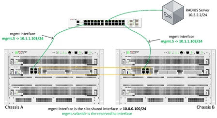

FortiGate-7000 diagram.
Use HA reserved interface along with RADIUS authentication on fortiGate-6000 and 7000.
HA reserved interface allow administrators to connect to each member of a cluster individually.
In this kind of setup the SLBC management interface 'slbc-mgmt-intf' defined in config load-balance setting will be used as source IP to reach the RADIUS server.
The 'mgmt-vdom' should have an IP route to reach the RADIUS Server.
The IP address of the' slbc-mgmt-intf' should be the only IP client known by the RADIUS server.
Master chassis will contact the RADIUS server directly.
Slave chassis will send RADIUS traffic to master chassis via internal base network using HA link.

Packets on slave unit are sourced by elbc-base-mgmt interface of FIM1 (internal chassis network).
Then it goes to master device via HA interface (havdlink1).
Master unit will source NAT the traffic with the SLBC MGMT interface to reach the RADIUS server.
The reply from RADIUS server uses the same path.
