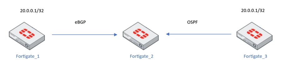

Design brief:
FortiGate 1: Network 20.0.0.1/32 advertised to BGP peer, and eBGP is implemented between FortiGate 1 and FortiGate 2.
FortiGate 2: Runs both OSPF and BGP, and it learns the route 20.0.0.1/32 from eBGP as well as OSPF.
FortiGate 3: Network 20.0.0.1/32 is advertised in the OSPF domain.
