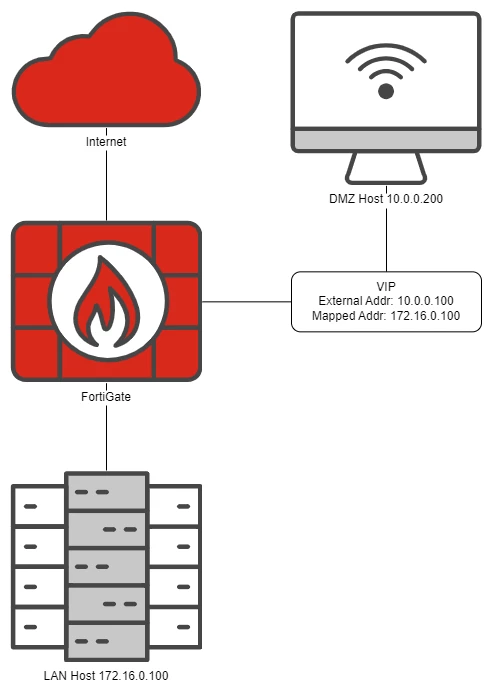

  • The FortiGate is configured with a WAN interface, a DMZ interface, and an internal LAN interface.
  • Firewall Policies have been configured for LAN to WAN as well as DMZ to LAN. Notably, the LAN to WAN policy has Source NAT enabled and set for the Outgoing Interface Address.
  • A VIP is configured with the 'any' interface and applied to the DMZ to the LAN policy. The External IP is set to 10.0.0.100, and the Mapped IP is set to the LAN Host (172.16.0.100).
  • The admin in this scenario wants the following outcomes:
    1. The DMZ host should be able to initiate traffic to the LAN host using destination 10.0.0.100 (which DNATs to 172.16.0.100).
    2. The LAN host should be able to initiate traffic to the Internet and be SNAT'd to FortiGate's WAN public IP address.

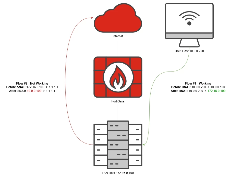

After everything is configured in the above scenario, the following behavior is observed during testing:
  1. When the DMZ Host sends traffic to 10.0.0.100, the FortiGate translates the destination to 172.16.0.100 and sends it to the LAN Host successfully (Good).
  2. When the LAN host sends traffic to the Internet via the WAN interface, it will fail to receive any responses from Internet destinations (Bad).
After some troubleshooting, the admin finds that the LAN host's traffic arrives on the FortiGate and is Source NAT'd to 10.0.0.100, rather than the FortiGate's outgoing WAN interface address.
In this scenario, the conditions have been met for using the 'any' VIP's External Address for outgoing Source NAT (Traffic sourced from 172.16.0.100 that is egressing 'any' interface using a Firewall Policy with SNAT enabled), so the LAN Host is SNAT'd to the VIP address rather than the Outgoing Interface Address of the WAN interface.
If a specific interface is set on the VIP instead of 'any' (for example, using the DMZ interface instead), then this issue would not have occurred, and traffic going from LAN to WAN would instead use the WAN interface address for Source NAT.
