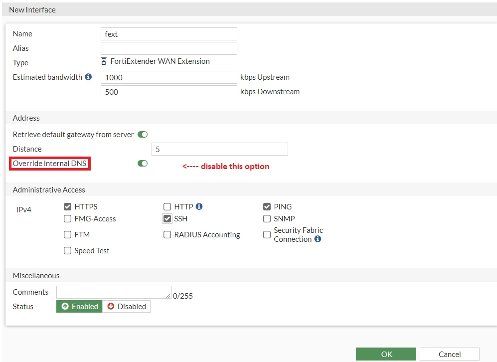

This article describes the situation when utilizing a FortiExtender interface for SD-WAN and the mobile ISP DNS is overriding the FortiGate system DNS.
This can be a problem as often DNS servers provided by the mobile carrier only allow connections for carrier clients.
In this case, DNS traffic across all other SD-WAN member interfaces will fail.
This behavior is caused by the ‘set dns-server-override‘ being enabled by default on interface settings and the fact that often a mobile ISP provides services via DHCP.
FortiGate.
To correct it, disable this setting under the FortiExtender virtual interface on the FortiGate.
Disabling this prevents the interface from using a DNS server acquired via DHCP or PPPoE.
config system interface
    edit <name of your FortiExtender interface>
        set dns-server-override disable
This is also applicable for other internet providers or LTE modems that utilize DHCP.  The 'Override internal DNS' option is also available under another interface such as WAN1 or WAN2.
