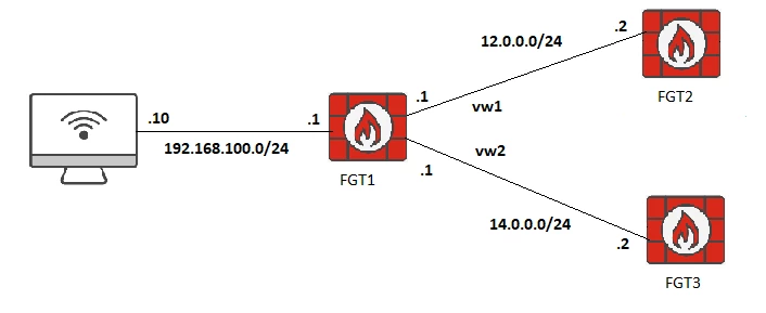

Description This article describes how the FortiGate performs route lookup for policy routes when the gateway has not been defined on v7.0.1 and above.
Scope FortiGate.
The Firewall routes the packet to the configured interface and gateway defined in the policy route and bypasses the routing table, or it stops checking the policy routes and routes the packet based on the routing table

The packet is forwarded to the configured interface and gateway, bypassing the routing table.
  1. The interface is configured but no gateway is configured:

The firewall does a route lookup to determine the gateway, only evaluating the best routes via vw2, not the more specific 200.0.0.1/32 route via vw1.
  1. The interface is configured but no gateway is configured (active route in diff. interface):

FortiGate does a route lookup in the routing table to determine the gateway, but there is no active route over VW2.
Therefore, no appropriate next-hop is found, and the policy route is invalid. The firewall does not match the policy route, and traffic is forwarded according to a later policy route, or the routing table if no policy route matches.
This restriction applies even if the outgoing interface is point-to-point, such as an IPsec site-to-site tunnel. If an IPsec tunnel has a remote IP defined under Network -> Interfaces, this value can be used as a gateway for the policy route.
  1. The gateway is configured, but no Interface is configured:

The FortiGate does a recursive route lookup to determine the best route to the policy route gateway 14.0.0.2, and forwards according to the result.
The same logic also applies to SD-WAN rules, which are considered as policy routes themselves.  To differentiate between PBR and SD-WAN rules in the debug flow, they are assigned different IDs.
