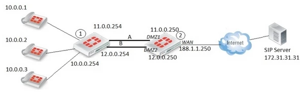

Some network topologies might require a policy route to have SIP traffic correctly routed through the FortiGate. In this case, it is important that the gateway is not defined in the policy route.
Consider the network topology as shown in the following diagram:
- FortiGate 1 has a static default route via link A.
- FortiGate 2 has a static route to send traffic to subnet 10.0.0.0/24 through link B.
- Both FortiGates use SIP ALG and have policy configured to allow voice traffic.
In the topology, SIP packets from the phone to the SIP server are routed through link A.
SIP packets sent by the server and allowed by an expected session (created by ALG) are routed via link B.
This creates an asymmetric routing condition and the traffic initiated by the SIP server will be dropped by FortiGate 1 if no policy route is in place. It is inadvisable to use this topology or to enabl asymmetric routing in FortiGate 1 (Read this for more details: Technical Tip: How the FortiGate behaves when asymmetric routing is enabled).
If the general routing on the FortiGate cannot be modified under these conditions, a policy route can be used as a solution.
1) On FortiGate 2, configure a Policy route to force traffic from the SIP server through link A.

These settings with a policy route and a lower priority static route will allow the traffic to be routed through the same link in both directions, and will allow SIP ALG to work correctly.
3) Why is it necessary to use a static route instead of a default gateway in policy route?
If a gateway is configured at the policy route level, the traffic handled by SIP ALG on FortiGate 2 will unexpectedly rewrite the destination IP and set it to the gateway IP.

3) The packet is routed to link A, DMZ1, but the destination IP of the packet is modified. It has become the Gateway IP configured in Policy route instead of phone IP.
