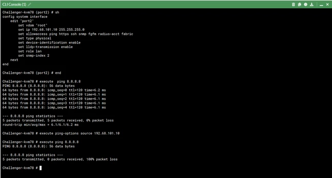

Trying to test connectivity via the command 'exec ping-options source <IP>' and then trying to ping the internet will not work (exec ping 8.8.8.8).
Ping from an interfacePing from an interface
Only echo request going, no responseOnly echo request going, no response

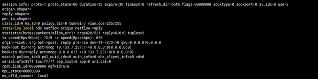

Debug flow:
Session output:

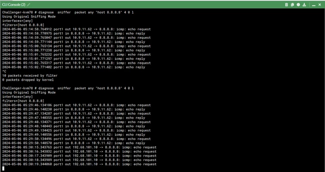

By default, FortiGate can ping from only the interface from which the route is present in the FIB table. The reason is that the traffic generated from the firewall will be direct, and no security policies will come into play. Hence, there will be no NATting triggered, and this is by design.
For example, trying to ping from a LAN port to the internet.
LAN port IP: 10.10.10.1
WAN port IP: X.X.X.X <- On the firewall.
Flow: Ping initiated from 10.10.10.1 <-----> ISP Gateway Router
Now, the ISP router will not recognize the internal IP, as it is expecting traffic from only X.X.X.X. Because of this, a drop will occur.
