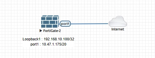

Setup:

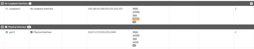

For testing purposes, assume that the FortiGate's port1 IP address 10.47.1.175/20 is a Public IP address.
Interface Setting:

Initiating PING traffic from FortiGate using the Loopback IP 192.168.10.100 (Private IP) as the source IP and Public IP 1.1.1.1 as the destination IP. It will show that the PING will fail.
