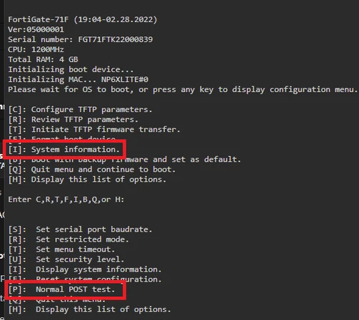

When the FortiGate is failing to boot up, or a specific feature in the BIOS needs to be tested, it is possible to do a POST test on the FortiGate.
This can be done by interrupting the BIOS when starting up, then by pressing [I] and then [P] in the menu:

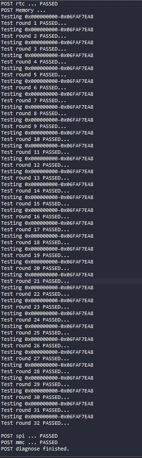

Here is an example of a POST test that passes:

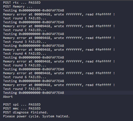

Here is an example of a failed POST test due to a RAM problem:
