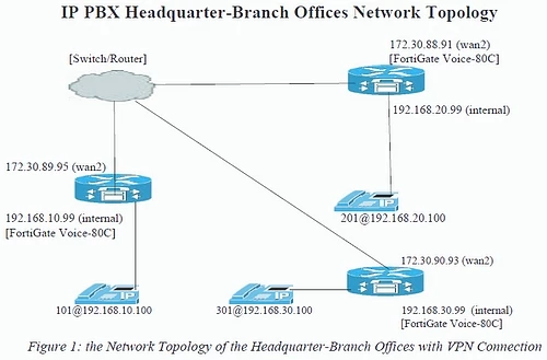

This technical tip provides an example of how to deploy an IP PBX system between the Branch Offices and the Headquarters Office with VPN connection in a corporate network.
In this example, the "ABC" company has a Headquarters Office (Site_A) at Sunnyvale in the United States, a Branch Office (Site_B) at Beijing in China, and a Branch Office (Site_C) at San Jose in United States. When business is growing up, the telephone usage is getting heavier between the Branch Offices and the Headquarters Office.  It is ideal solution for providing low cost communications between Branch Offices and Headquarter Office. "ABC" chooses FortiGate Voice-80C IP PBX to deploy IP telephony between the Branch Offices and the Headquarters Office. Through the VPN Connection, the FortiGate Voice-80C at the Branch offices can be connected to the FortiGate Voice-80C at the Headquarters office. Every employee can be reached via a 3-digit extension by a simple dialing plan configuration.
The FortiGate Voice-80C is a multi-function, multi-threat security platform that connects and protects remote and branch offices. It combines the functionality of a multi-threat UTM security gateway, VoIP gateway, IP PBX, VPN with strong encryption, router and switch into a single, integrated device.
FortiGate Voice-80C meets the needs of small, medium, or branch offices to do more without spending more. It delivers integrated data security, VoIP support, and a full-featured PBX, all managed by a single console. The IP PBX features include voicemail, message notification and unified messaging with interactive voice response (IVR). It provides support for SIP Trunking (Class 5 PSTN bypass) and supports standard SIP terminals, including hard- and softphones and SIP applications.
The setup is as follows:
Headquarter Office (Site_A) FortiGate Voice-80C (internal:192.168.10.99, wan2: 172.30.89.95).
Branch Office (Site_B) FortiGate Voice-80C (internal:192.168.20.99, wan2: 172.30.88.91).
Branch Office (Site_C) FortiGate Voice-80C (internal:192.168.30.99, wan2: 172.30.90.93).
FortiGate Voice-80C Devices, SIP Phones, Network Switch and Router

DIDs: 1604XXXXXXX
FortiFAX: 1604XXXXXXX
Toll Frees: 1866XXXXXXX
SIP Status: OK
11. Go to PBX -> Extension -> Extension:
Create some extension numbers (for example, 101, 102, 103, and so on):
CLI Configuration of PBX Extension:
config pbx extension
    edit "101"
        set dialplan "company-default"
        set first-name "w401"
        set last-name "q401"
        set secret Ab123456
        set vm-secret 1111
    edit "102"
        set first-name "w101"
        set last-name "q101"
        set secret Ab123456
        set vm-secret 1111
12. Go to Log&Report -> Log Config -> Alert E-mail:
SMTP Server: mail.fortinet.com
Email from: email@fortinet.com
Email to: email@fortinet.com
Authentication: Disabled
CLI Configuration of System Alert Email:
config system alertemail
    set server "mail.fortinet.com"
config alertemail setting
    set username "email@fortinet.com"
    set mailto1 "email@fortinet.com"
Branch Office (Site_B FortiGate Voice-80C) Configuration
1. Go to VPN -> Auto Key (IKE):
(1) Phase 1:
             Name – PBX_SPOKE1
             Remote Gateway – Static IP Address
             IP Address – 172.30.89.95
             Local Interface – wan2
             Mode – Main (ID Protection)
             Authentication Method – Preshared Key
             Pre-shared Key – test12345
             Accept any Peer ID – Yes
             Enable IPSec Interface Mode – Yes
             IKE Version – 1
             Local Gateway IP – Main Interface IP
             DH Group – 5
                               XAUTH – Disabled
             NAT Traversal – Enabled
             Dead Peer Detection – Enabled
             Keepalive Frequency – 10 seconds
(2) Phase 2:
             Name – VPN_SPOKE1
             Phase 1 – PBX_SPOKE1
             Auto Key Keep Alive – Enabled
                               Quick Mode Selector – Source address: Specify 0.0.0.0/0
                                                                     Destination address: Specify 0.0.0.0/0
CLI Configuration of VPN Auto Key (IKE):
    edit "PBX_SPOKE1"
        set interface "wan2"
        set proposal 3des-sha1 aes128-sha1
        set remote-gw 172.30.89.95
        set psksecret test12345
    edit "VPN_SPOKE1"
        set keepalive enable
        set phase1name "PBX_SPOKE1"
2. Go to Firewall -> Address:
(1) Site_HUB: 192.168.201.1/255.255.255.255
                       Interface – any
(2) Destination: 192.168.0.0/16
                     Interface – PBX_SPOKE1
(3) Source: 192.168.20.0/24
              Interface – Internal
(4) All: 0.0.0.0/0.0.0.0
       Interface – Any
CLI Configuration of Firewall Address:
config firewall address
    edit "all"
    edit "Site_HUB"
        set subnet 192.168.201.1 255.255.255.255
    edit "Destination"
        set associated-interface "PBX_SPOKE1"
        set subnet 192.168.0.0 255.255.0.0
    edit "Source"
        set associated-interface "internal"
        set subnet 192.168.20.0 255.255.255.0
3. Go to System -> Network -> Interface:
(1) Wan2: 172.30.88.91/24
(2) Internal: 192.168.20.99/24
                     SIP Traffic – Enabled
                     PBX User Portal – Enabled
                     Phone Auto-Provision – Enabled
(3) PBX_SPOKE1: 192.168.201.2/255.255.255.255
              IP – 192.168.201.2
              Remote IP – 192.168.201.1
CLI Configuration of System Network Interface:
config system interface
    edit "wan2"
        set vdom "root"
        set ip 172.30.88.91 255.255.255.0
        set allowaccess ping https ssh snmp http telnet
        set type physical
        set voip enable
        set pbx-user-portal enable
        set phone-auto-provision enable
    edit "internal"
        set vdom "root"
        set ip 192.168.20.99 255.255.255.0
        set type physical
        set voip enable
    edit "PBX_SPOKE1"
        set vdom "root"
        set ip 192.168.201.2 255.255.255.255
        set type tunnel
        set remote-ip 192.168.201.1
        set voip enable
4. Go to System -> DHCP Server:
(1) Internal Server: Enabled
(2) Type: Regular
(3) IP Range: 192.168.20.100 – 192.168.20.250
(4) Mask: 255.255.255.0
(5) Default Gateway: 192.168.20.99
CLI Configuration of System DHCP Server:
config system dhcp server
        set default-gateway 192.168.20.99
        set interface "internal"
            config ip-range
                    set end-ip 192.168.20.250
                    set start-ip 192.168.20.100
        set netmask 255.255.255.0
        set dns-server1 208.91.112.53
5. Go to Firewall -> Policy:
(1) PBX_SPOKE1 -> internal:
                             Source Interface – PBX_SPOKE1
                             Source Address (Multiple) – (Destination + Site_HUB)
                             Destination Interface – internal
                             Destination Address – Source
                             Schedule – Always
                             Service – ANY
                             Action – ACCEPT
                             NAT – No NAT
(2) Internal -> PBX_SPOKE1:
                             Source Interface – internal
                             Source Address – Source
                             Destination Interface – PBX_SPOKE1
                             Destination Address (Multiple) – (Destination + Site_HUB)
                             Schedule – Always
                             Service – ANY
                             Action – ACCEPT
                             NAT – No NAT
CLI Configuration of Firewall Policy:
config firewall policy
    edit 5
        set srcintf "PBX_SPOKE1"
        set dstintf "internal"
            set srcaddr "Site_HUB" "Destination"
            set dstaddr "Source"
            set service "ANY"
    edit 6
        set srcintf "internal"
        set dstintf "PBX_SPOKE1"
            set srcaddr "Source"
            set dstaddr "Site_HUB" "Destination"
            set service "ANY"
6. Go to Router -> Static -> Static Router:
(1) Destination IP: 192.168.0.0/255.255.0.0
                         Gateway – 0.0.0.0
                         Device – PBX_SPOKE1
                         Distance – 10
                         Priority – 0
(2) Destination IP: 0.0.0.0/0.0.0.0
                         Gateway – 172.30.88.1
                         Device – wan2
                         Distance – 10
                         Priority – 0
CLI Configuration of Router:
config router static
        set device "wan2"
        set gateway 172.30.88.1
        set device "PBX_SPOKE1"
        set dst 192.168.0.0 255.255.0.0
7. Go to PBX -> Service Providers -> Branch Office:
Prefix:
Pattern: [1,3]XX
IP Address: 192.168.201.1
Registration: No
Dial Plan: qtest
CLI Configuration of PBX Branch Office:
config pbx branch-office
    edit "Site_A"
        set domain "192.168.201.1"
        set extpattern "[1,3]XX"
        set dialplan "qtest"
        set registration no
8. Go to PBX -> Calling Rules -> Dial Plan -> qtest:
(1) wtest:
           Use Default Outgoing Prefix (“9”) – Yes
           Phone Number Begin with –
           Prepend –
           Action – Allow
           Outgoing -
CLI Configuration of PBX Dial Plan:
config pbx dialplan
    edit "qtest"
            config rule
                edit "wtest"
                    set action allow
9. Go to PBX -> Extension -> Extension:
Create some extension numbers (for example, 201, 202, 203, and so on):
    edit "201"
        set first-name "w201"
        set last-name "q201"
        set secret Ab123456
        set vm-secret 1111
Branch Office (Site_C FortiGate Voice-80C) Configuration
(1) Phase 1:
             Name – PBX_SPOKE2
             IKE Version – 1
             DH Group – 5
                               XAUTH – Disabled
(2) Phase 2:
             Name – VPN_SPOKE2
             Phase 1 – PBX_SPOKE2
    edit "PBX_SPOKE2"
    edit "VPN_SPOKE2"
        set phase1name "PBX_SPOKE2"
(1) Site_HUB: 192.168.202.1/255.255.255.255
                       Interface – any
                     Interface – PBX_SPOKE2
(3) Source: 192.168.30.0/24
       Interface – Any
    edit "all"
    edit "Site_HUB"
        set subnet 192.168.202.1 255.255.255.255
    edit "Destination"
        set associated-interface "PBX_SPOKE2"
    edit "Source"
        set subnet 192.168.30.0 255.255.255.0
(1) Wan2: 172.30.90.93/24
(2) Internal: 192.168.30.99/24
(3) PBX_SPOKE2: 192.168.202.2/255.255.255.255
              IP – 192.168.202.2
              Remote IP – 192.168.202.1
    edit "wan2"
        set vdom "root"
        set ip 172.30.90.93 255.255.255.0
        set type physical
        set voip enable
    edit "internal"
        set vdom "root"
        set ip 192.168.30.99 255.255.255.0
        set type physical
        set voip enable
    edit "PBX_SPOKE2"
        set vdom "root"
        set ip 192.168.202.2 255.255.255.255
        set type tunnel
        set remote-ip 192.168.202.1
        set voip enable
(2) Type: Regular
(3) IP Range: 192.168.30.100 – 192.168.30.250
(5) Default Gateway: 192.168.30.99
        set default-gateway 192.168.30.99
            config ip-range
                    set end-ip 192.168.30.250
                    set start-ip 192.168.30.100
        set dns-server1 208.91.112.52
(1) PBX_SPOKE2 -> internal:
                             Source Interface – PBX_SPOKE2
                             Schedule – Always
                             Service – ANY
                             Action – ACCEPT
                             NAT – No NAT
(3) Internal -> PBX_SPOKE2:
                             Destination Interface – PBX_SPOKE2
                             Schedule – Always
                             Service – ANY
                             Action – ACCEPT
                             NAT – No NAT
    edit 3
        set srcintf "PBX_SPOKE2"
            set srcaddr "Destination" "Site_HUB"
            set service "ANY"
    edit 4
        set dstintf "PBX_SPOKE2"
            set dstaddr "Destination" "Site_HUB"
            set service "ANY"
                         Gateway – 0.0.0.0
                         Device – PBX_SPOKE2
                         Distance – 10
                         Priority – 0
                         Gateway – 172.30.90.1
