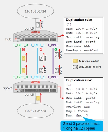

In the topology below, 2 FortiGates are connected through 3 IPSec overlays, which are members of the overlay zone.
Spoke CLI configuration:
config system sdwan
    set duplication-max-num 3
        config duplication
              set srcaddr "10.0.1.0/24"
              set dstaddr "10.1.0.0/24"
              set srcintf "port5"
              set dstintf "overlay"
              set service "ALL"
              set packet-duplication force

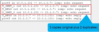

On the Spoke FortiGate, duplication-max-num is set to 3. This indicates that FortiGate will forward up to three copies of each packet: the original packet plus two duplicates. Each copy is sent through a different SD-WAN member.
Hub CLI configuration:
config system sdwan
    config duplication
            set srcintf "overlay"
            set dstintf "port5"
            set service "ALL"
            set packet-de-duplication enable

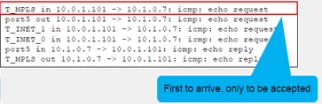

On the hub side, packet-de-duplication is enabled to instruct the FortiGate to accept only one copy of the packet. The first packet to arrive will be accepted, and additional copies will be dropped.
Packet capture on the Spoke side:
Packet capture on the Hub Side:
