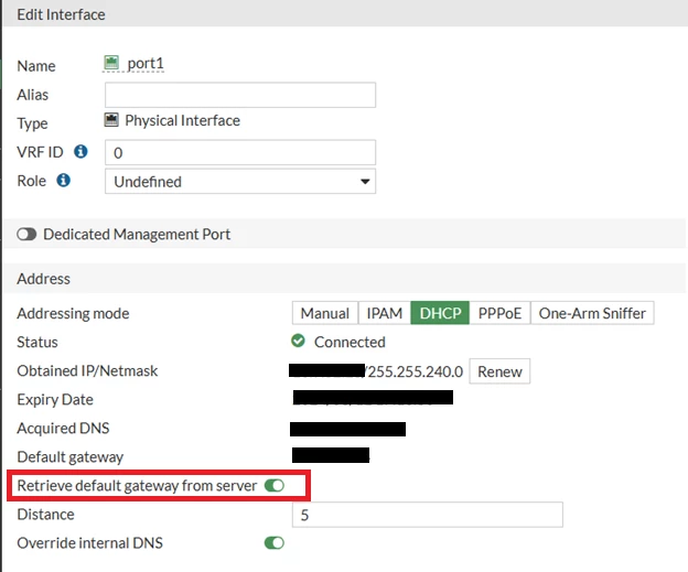

When on the DHCP WAN interface, if the 'Retrieve default gateway from server' option is enabled as shown below:

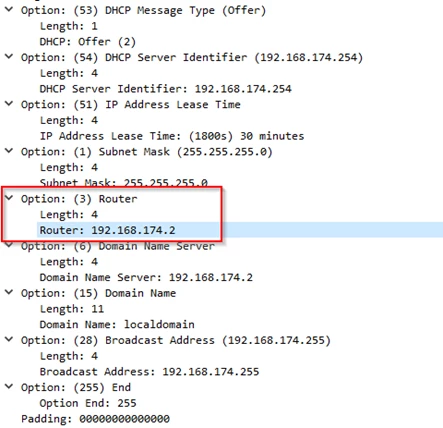

Then the DHCP server can send a gateway address with Option 3 (Router) on a DHCP offer message:
With this, the FortiGate will add the following default route in the routing table; the administrative distance of the default route added by the DHCP mode will be 5 by default. It will naturally override the static route of the interfaces set to Manual Addressing mode since it has a default Administrative distance of 10.

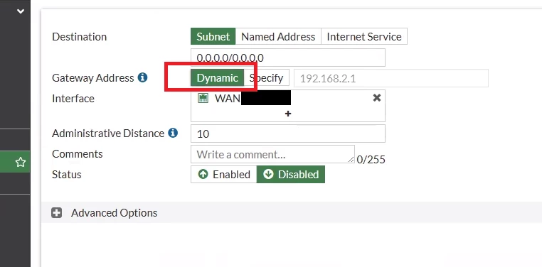

From the GUI, when creating a static route, after selecting the DHCP interface under interfaces, it will give an option to select the Dynamic as the gateway address:
With the dynamic gateway option enabled, the static route will update the default gateway by itself whenever there is a change in the default gateway.
