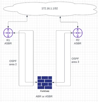

As shown in the below topology, FortiGate has two OSPF adjacencies with R1 and R2.
The OSPF area between FortiGate and R1 is area 2 and area 3 between FortiGate and R2, both areas are normal OSPF areas.
However, the areas can be special areas such as stubby or NSSA.
Both R1 and R2 are ASBR, they are redistributing the subnet 172.16.1.1/32 into OSPF from another administrative domain.
