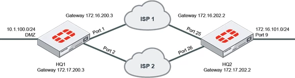

This is a sample configuration of using OSPF with IPsec VPN to set up network redundancy.
Route selection is based on OSPF cost calculation.
Configure ECMP or primary/secondary routes by adjusting OSPF path cost.
Because the GUI can only complete part of the configuration, using the CLI is recommended.
To configure OSPF with IPsec VPN to achieve network redundancy using the CLI:
Each FortiGate has two WAN interfaces connected to different ISPs.
The ISP1 link is for the primary FortiGate and the IPS2 link is for the secondary FortiGate.
Configure HQ1.
- Configure the WAN interface and static route.
Configure HQ1.

Configure HQ2.

- Configure the internal (protected subnet) interface.
Configure HQ1.

Configure HQ2.

# config ospf-interface
edit "pri_HQ1"
set interface "pri_HQ1"
set cost 10
set network-type point-to-point
edit "sec_HQ1"
set interface "sec_HQ1"
set cost 20
edit 0.0.0.0
edit "pri_HQ1"
set cost 10
edit "sec_HQ1"
set cost 20
# config network
set prefix 10.10.10.0 255.255.255.0
set prefix 10.10.11.0 255.255.255.0
edit 3
set prefix 172.16.101.0 255.255.255.0
edit 3
To check VPN and OSPF states using diagnose and get commands:
- Run the HQ1 # diagnose vpn ike gateway list command. The system should return the following:
vd: root/0
version: 1
interface: port1 11
addr: 172.16.200.1:500 -> 172.16.202.1:500
virtual-interface-addr: 10.10.10.1 -> 10.10.10.2
created: 1024s ago
IKE SA: created 1/1 established 1/1 time 0/0/0 ms
IPsec SA: created 1/3 established 1/2 time 0/5/10 ms
id/spi: 45 d184777257b4e692/e2432f834aaf5658 direction: responder status: established 1024-1024s ago = 0ms proposal: aes128-sha256 key: 9ed41fb06c983344-189538046f5ad204 lifetime/rekey: 86400/85105 DPD sent/recv: 00000003/00000000 vd: root/0
version: 1
interface: port2 12
addr: 172.17.200.1:500 -> 172.17.202.1:500
virtual-interface-addr: 10.10.11.1 -> 10.10.11.2
created: 346s ago
IPsec SA: created 1/1 established 1/1 time 0/10/15 ms
id/spi: 48 d909ed68636b1ea5/163015e73ea050b8 direction: initiator status: established 0-0s ago = 0ms proposal: aes128-sha256 key: b9e93c156bdf4562-29db9fbafa256152 lifetime/rekey: 86400/86099 DPD sent/recv: 00000000/00000000
version: 1
interface: port1 11
created: 1024s ago
version: 1
interface: port2 12
created: 346s ago
- Run the HQ1 # diagnose vpn tunnel list command. The system should return the following:
List all ipsec tunnel in vd 0
name=pri_HQ2 ver=1 serial=1 172.16.200.1:0->172.16.202.1:0
bound_if=11 lgwy=static/1 tun=intf/0 mode=auto/1 encap=none/528 options[0210]=create_dev frag-rfc accept_traffic=1
proxyid_num=1 child_num=0 refcnt=14 ilast=2 olast=2 ad=/0
stat: rxp=102 txp=105 rxb=14064 txb=7816
dpd: mode=on-demand on=1 idle=20000ms retry=3 count=0 seqno=3
natt: mode=none draft=0 interval=0 remote_port=0
proxyid=pri_HQ2 proto=0 sa=1 ref=2 serial=1 auto-negotiate
src: 0:0.0.0.0/0.0.0.0:0 dst: 0:0.0.0.0/0.0.0.0:0 SA: ref=3 options=18227 type=00 soft=0 mtu=1438 expire=42254/0B replaywin=2048
seqno=6a esn=0 replaywin_lastseq=00000067 itn=0
life: type=01 bytes=0/0 timeout=42932/43200 dec: spi=1071b4ee esp=aes key=16 032036b24a4ec88da63896b86f3a01db
ah=sha1 key=20 3962933e24c8da21c65c13bc2c6345d643199cdf
enc: spi=ec89b7e3 esp=aes key=16 92b1d85ef91faf695fca05843dd91626
ah=sha1 key=20 2de99d1376506313d9f32df6873902cf6c08e454
dec:pkts/bytes=102/7164, enc:pkts/bytes=105/14936
name=sec_HQ2 ver=1 serial=2 172.17.200.1:0->172.17.202.1:0
bound_if=12 lgwy=static/1 tun=intf/0 mode=auto/1 encap=none/528 options[0210]=create_dev frag-rfc accept_traffic=1
proxyid_num=1 child_num=0 refcnt=14 ilast=3 olast=0 ad=/0
stat: rxp=110 txp=114 rxb=15152 txb=8428
proxyid=sec_HQ2 proto=0 sa=1 ref=2 serial=1 auto-negotiate
src: 0:0.0.0.0/0.0.0.0:0 dst: 0:0.0.0.0/0.0.0.0:0 SA: ref=3 options=18227 type=00 soft=0 mtu=1438 expire=42927/0B replaywin=2048
seqno=2 esn=0 replaywin_lastseq=00000002 itn=0
life: type=01 bytes=0/0 timeout=42931/43200 dec: spi=1071b4ef esp=aes key=16 bcdcabdb7d1c7c695d1f2e0f5441700a
ah=sha1 key=20 e7a0034589f82eb1af41efd59d0b2565fef8d5da
enc: spi=ec89b7e4 esp=aes key=16 234240b69e61f6bdee2b4cdec0f33bea
ah=sha1 key=20 f9d4744a84d91e5ce05f5984737c2a691a3627e8
dec:pkts/bytes=1/68, enc:pkts/bytes=1/136
- Run the HQ1 # get router info ospf neighbor command. The system should return the following:
OSPF process 0, VRF 0:
Neighbor ID Pri State Dead Time Address Interface
2.2.2.2 1. Full/ - 00:00:37 10.10.10.2 pri_HQ2
2.2.2.2 1. Full/ - 00:00:32 10.10.11.2 sec_HQ2
- Run the HQ1 # get router info routing-table ospf command. The system should return the following:
Routing table for VRF=0
O 172.16.101.0/24 [110/20] via 10.10.10.2, pri_HQ2 , 00:03:21
In case the primary tunnel is down after route convergence.
5. Run the HQ1 # get router info routing-table ospf command. The system should return the following:
O 172.16.101.0/24 [110/110] via 10.10.11.2, sec_HQ2 , 00:00:01
