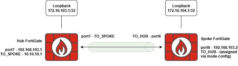

The topology consists of two FortiGates in a hub-and-spoke topology:
While the VPN tunnel IP addresses (aka 'overlay IPs') of the spoke can be assigned manually, a more scalable solution for larger environments is to utilize IKE mode-config for dynamic address assignment. IKE mode-config will be used in this example deployment.

  • The Hub is assigned a manual fixed address with a /32 subnet mask (set ip x.x.x.x 255.255.255.255), whereas the Spokes will receive IP addresses dynamically from the Hub after connecting to the VPN.
  • The address for remote-ip does not technically matter, as its function is to instruct the Hub FortiGate about the general subnet associated with the tunnel interface (e.g., 10.10.10.0/24 in the above setting). The last IP address of the subnet range is specified here (e.g., 10.10.10.254).

There is no need for manual IP address assignment on the Spokes since the Hub FortiGate will dynamically assign an IP address via mode-config.

Spokes are set to network-type point-to-point since they only form neighborships back to the Hub FortiGate (the dialup VPN is a non-broadcast network, and so Spokes will not form neighborships with other Spokes).
