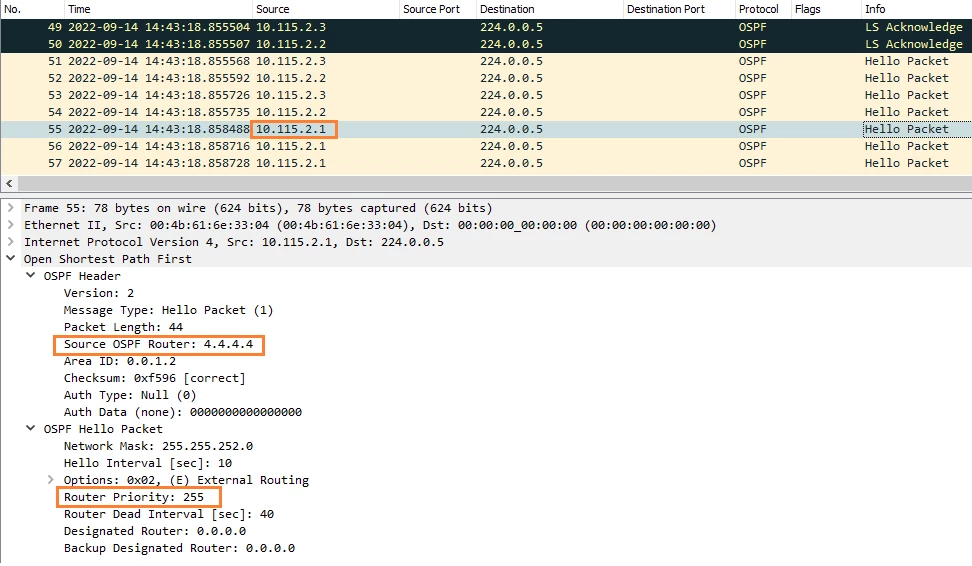

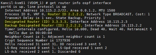

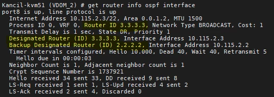

In the following scenario, VDOM1 and VDOM2 have already formed OSPF neighbors between each other before the root VDOM was introduced.
VDOM2 is the Designated Router(DR) due to having a higher router ID while VDOM1 is the Backup Designated Router(BDR).
VDOM1.
VDOM2.

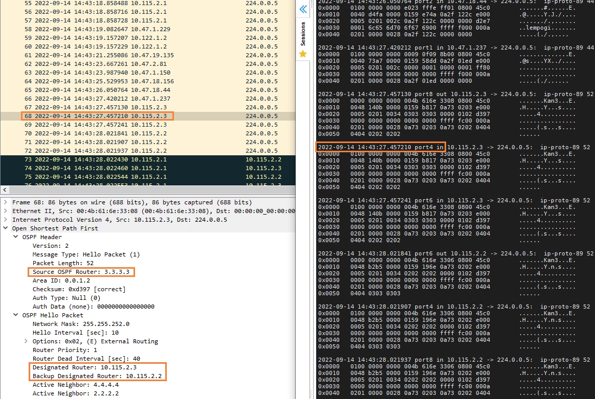

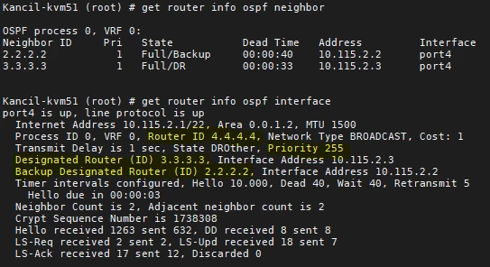

After introducing root VDOM to the same OSPF area, even though root VDOM has higher priority and router-id, VDOM2 was still the DR and VDOM1 was still the BDR.

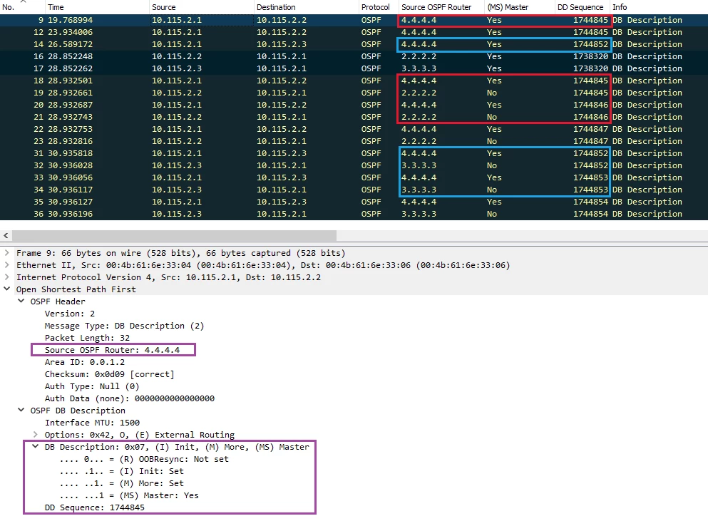

This is because during init state, VDOM1 and VDOM2 have already informed the root of the current DR and BDR.
This is in accordance with the RFC 2328.
However, note that regardless of whichever is the DR and BDR, the router with the highest router ID will still be the master during DD packet exchange.
In order to make the root VDOM the DR, clear the OSPF neighbor ship for the current DR so the root VDOM has higher priority and the router-id can take it as the new DR.
