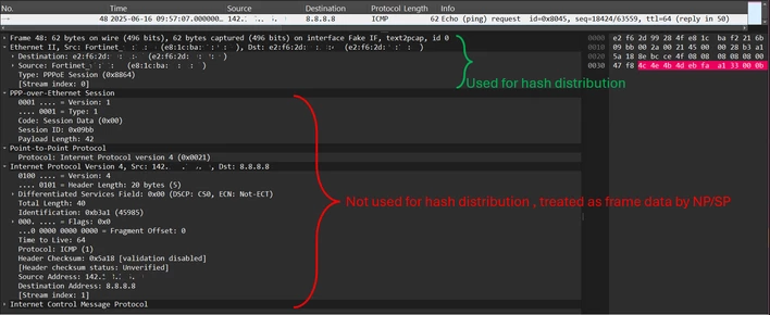

By default, load distribution is primarily done on interface ingress and the resulting interrupts are distributed towards available CPUs via a hash-based distribution (from whichever L2/L3/L4 headers are available).
Due to the NP6, NP6lite, NP6xlite, NP7, and NP7lite not being able to understand PPPoE session frames (ethertype 0x8864) and being unable to look beyond the PPPoE/PPP headers into the IP headers situated within, only the L2 headers are used to distribute to available CPUs. The active PPPoE session would only be sourced from the modem's single MAC address towards the FortiGate interface MAC address, resulting in all ingress PPPoE packets being sent to one CPU only.
Because of this, performance will vary depending on the single-thread performance of the CPU installed in a given FortiGate.

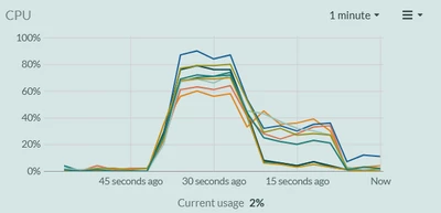

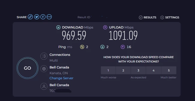

The following is an example of default behavior (FG101F, X2 is PPPoE, Client on X1, Service Down:1.5G/Up:1G) where one core is significantly higher than the rest and downlink speeds cannot be reached.

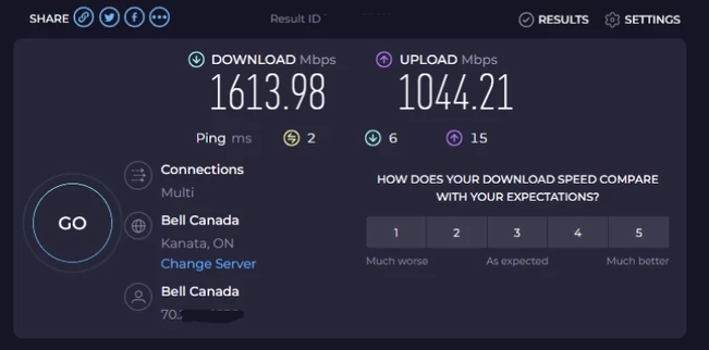

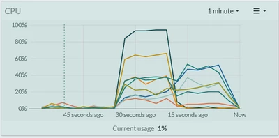

In the same environment as above with round-robin distribution, utilization is more even across all cores and the downlink speed is reached:
