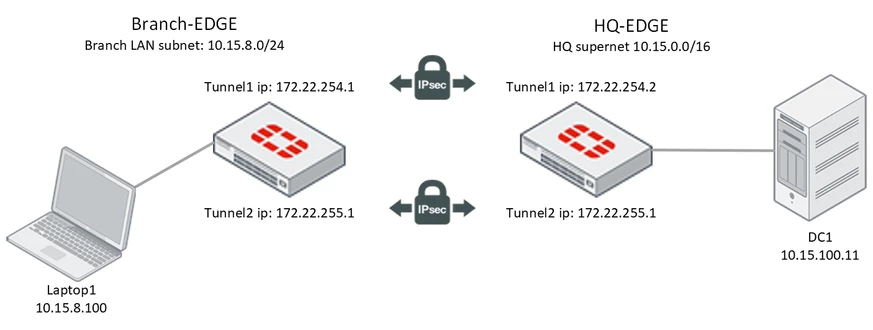

Topology:
In this environment, Tunnel1 is the preferred link for sending data traffic between the two sites. Tunnel2 is intended as a backup.

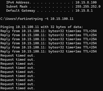

For the test, there is an issue for HQ-Tunnel1 to Branch-Tunnel1 data traffic but other Internet traffic passes as normal between the sites. In this case, Dead Peer Detection will not bring down the tunnel and any failover mechanisms that rely on this will not activate.
keep-alive-timer and holdtime-timer:

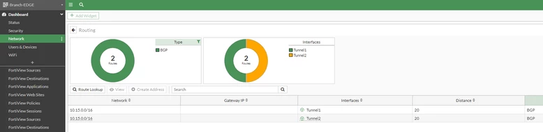

With default settings, it takes a minimum of 120 seconds for routes over Tunnel1 to be removed. During this time the network will be disrupted even though there are valid routes available over Tunnel2.

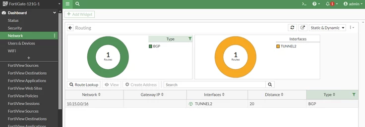

After at most 180 seconds, the BGP neighbor goes down on both sides. The non-functioning neighbor’s routes are removed and traffic fails over to Tunnel2 as intended.
To optimize this behavior, set a shorter keep-alive-timer and holdtime-timer.

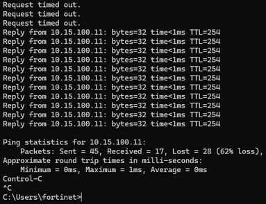

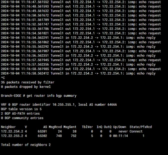

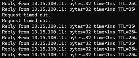

Sometime later, the tunnel issue has been resolved and Branch-EDGE can receive tunnel data traffic from HQ-EDGE. There is a delay of up to 60 seconds before the Tunnel1 neighborship is established.
By default the connect-timer is dynamic. Both sides are trying to bring the neighborship up, but the time between connection attempts is variable.
To optimize this behavior, set a short connect-timer.

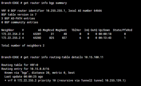

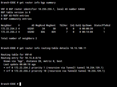

After the BGP neighborship is re-established, there is a delay of 30 seconds before Branch-EDGE receives any routes.
Initially, 172.22.254.2 will show as up but there will be no routes from it.
This is because HQ-EDGE is configured with the advertisement interval of 30 seconds. Branch-EDGE receives the route after 30 seconds.
