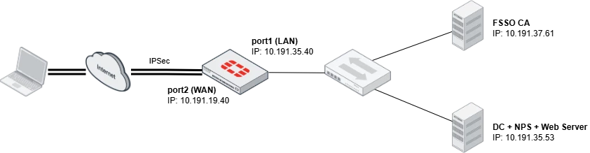

This article describes an issue with RADIUS Accounting when using IKEv2 with a remote RADIUS User.
When using IKEv2 with RADIUS authentication, RADIUS Accounting packets can be seen on the RADIUS Server for users on the RADIUS Server, however, when a 'Remote RADIUS User' config is used (in order to use FortiToken), there are no RADIUS Accounting packets.

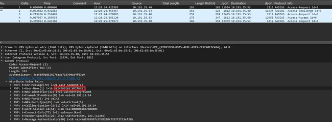

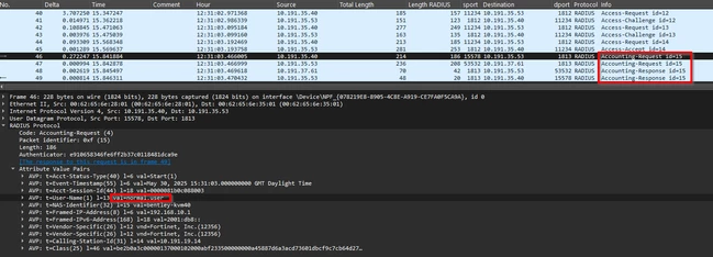

A capture on both scenarios shows that RADIUS Accounting packets are not being sent for the case when a Remote RADIUS user is being used.
RADIUS User: normal.user.
Remote RADIUS User: tobias.ahlfors.
Note: This is currently under investigation, and there is no fix available yet.
This only affects IKEv2 with Remote RADIUS User, on IKEv1, there is no issue, so a possible workaround is to use IKEv1 if FortiToken is mandatory.
