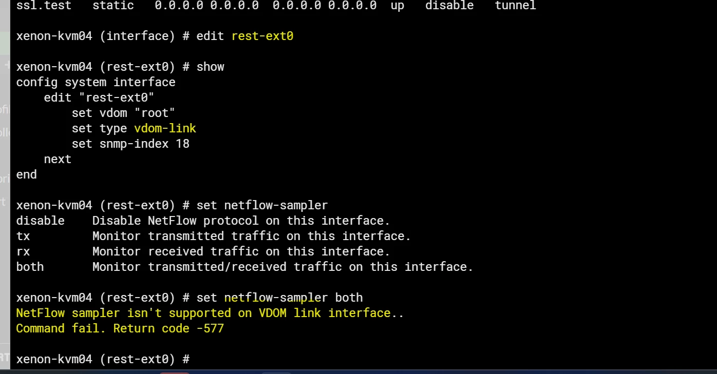

Description This article describes how to resolve the error 'Netflow sampler is not supported on Vdom link interface' when enabling the netflow sampler on the Vdom link interface.
Scope FortiGate.
Creating a NetFlow sampler will not support the VDOM link interface.

For NetFlow (or sFlow) to function, the sampling engine must be able to inspect packets as they flow through a specific interface. The sampler taps into the packet forwarding path of that interface, creates flow records, and exports them to a collector.
The sampling typically happens at a point in the data plane that is associated with a 'real' ingress or egress interface.
Internal VDOM-to-VDOM traffic via the vdom-link bypasses the standard hardware or software data path hooks where the NetFlow sampler is active. The vdom-link traffic is an internal transaction between two isolated routing instances (VDOMs).
From FortiOS's perspective:
  • Traffic enters a physical port in VDOM-A.
  • It is processed by VDOM-A's firewall policies/routing.
  • It is handed off internally to VDOM-B via vdom-link.
  • It is processed by VDOM-B's firewall policies/routing.
  • It exits a physical port in VDOM-B.
The NetFlow sampler can only sample traffic on the physical (or logical like VLAN) interfaces in VDOM-A and VDOM-B. The internal handoff point (vdom-link) is not equipped for flow sampling.
Reference output:
