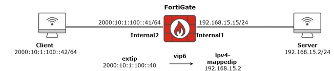

After configuring NAT64 or NAT46 as shown in NAT46 and NAT64 policy and routing configurations, if the IP pool was misconfigured to use the same IP address as the outgoing interface, reply traffic will be dropped by the FortiGate.
NAT64 Topology:
Example NAT64 Configuration:
