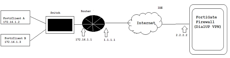

In certain scenarios, when multiple DialUP client behind the same NAT IP will negotiate on same remote public IP address will cause twin connections.
The complete packet flow in figure 1.1 (without NAT Traversal enabled) is explained:
The FortiGate is a state-full firewall and based on this 5 tuples (source IP, destination IP, destination port, source port, protocol (“service” in the settings).
Firewall will maintain the session state.
Considering scenario, with 2 DialUP clients behind the NAT device, when client A and B will send the IKE negotiation packet:
1st client session info in the FortiGate:
Source IP: 1.1.1.1 , Source port: 500
Destination IP: 2.2.2.2 , Destination port: 500
Protocol: UDP
2nd client session info in the FortiGate:
Protocol: UDP
As both the source IP and source port are same, the FortiGate gives an error twin connections detected in IKE debug logs and deletes old connection (SA) & negotiation tunnel with new connection(SA) which will cause tunnel flapping issue between client A and B.
IKE Debug log:
ike 1:YARD: adding new dynamic tunnel for 1.1.1.1:4500
ike 1:YARD_1: added new dynamic tunnel for 1.1.1.1:4500
ike 1:YARD_1:966: established IKE SA b8856983d6799880/c0a7742f2eb1f993
ike 1:YARD_1: twin connections detected                                                           <----- Error.
ike 1:YARD_0: deleting
ike 1:YARD_0: flushing
ike 1:YARD_0:965: send IPsec SA delete, spi 95d5b0d1

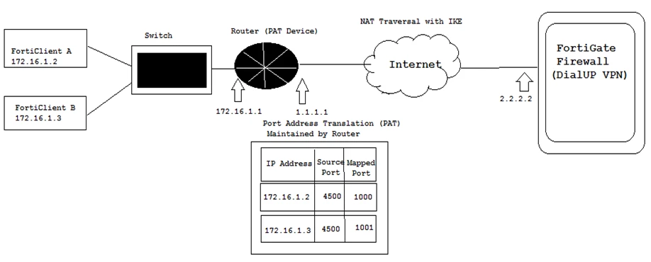

Network: Packet flow with NAT-T enabled in IPsec.
When the FortiGate is behind NAT and NAT-T is detected, the router should maintain PAT table where source Port 4500 will be mapped with dynamic port.
For more Information on NAT-T with IPSec, refer to RFC 3947. https://tools.ietf.org/html/rfc3947
If Client A sends a packet, the packet have this form :
(Client A )
[src: 171.16.1.2 :4500 dst: 2.2.2.2:4500]                                                                                       <-----  (router ) (PTable Sport:4500 mapped with 1000, Source NAT IP :1.1.1.1).
[src: 1.1.1.1 :1000 dst: 2.2.2.2:4500]                                                                                            <----- router forward that packet towards FortiGate firewall.
If Client B sends a packet, the packet have this form:
(Client B )
[src: 171.16.1.3 :4500 dst: 2.2.2.2:4500]                                                                                       <-----  (router ) (PTable Sport:4500 mapped with 1001, Source NAT IP :1.1.1.1).
[src: 1.1.1.1 :1002 dst: 2.2.2.2:4500]                                                                                             <----- router forward that packet towards FortiGate firewall.
As source ports are different in the IKE packet, the FortiGate maintains two different sessions and connections(SA) for the same public IP which resolves the twin connections error.
