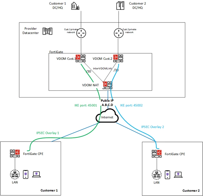

This article describes a configuration that uses multiple VDOMs as HUBs sharing a single public IP address. A NAT VDOM is used to forward custom IPsec ports among the Customer VDOMs.
In MSSP-like or multi-tenant environments where different customers use a HUB and Spoke overlay topology, sharing a FortiGate HUB device, VDOMs are used to separate customers from each other. Each VDOM will operate as a HUB dedicated to a particular customer organization. Usually, in this scenario, each HUB will be reachable from the dial-up spokes pointing to a customer dedicated public IP address or FQDN.
In some cases, the provider may need to share the public IP addresses, because the allocated IP addresses are not enough to cover their entire customer base on a 1:1 basis.
FortiOS: 7.0 and later:
General ArchitectureGeneral Architecture

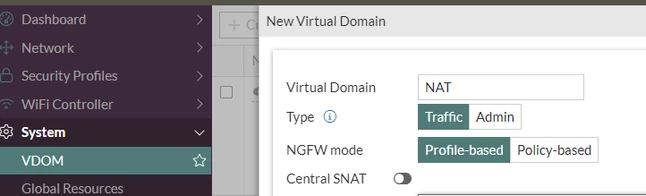

  1. Configure a VDOM named as 'NAT'. This VDOM will host the WAN Interface with the Public IP Address.
NAT VDOMNAT VDOM

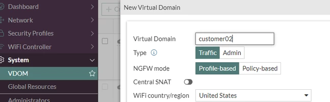

  1. Configure as many VDOMs as customers to deploy: Customer1… CustomerN.
Customer VDOMCustomer VDOM

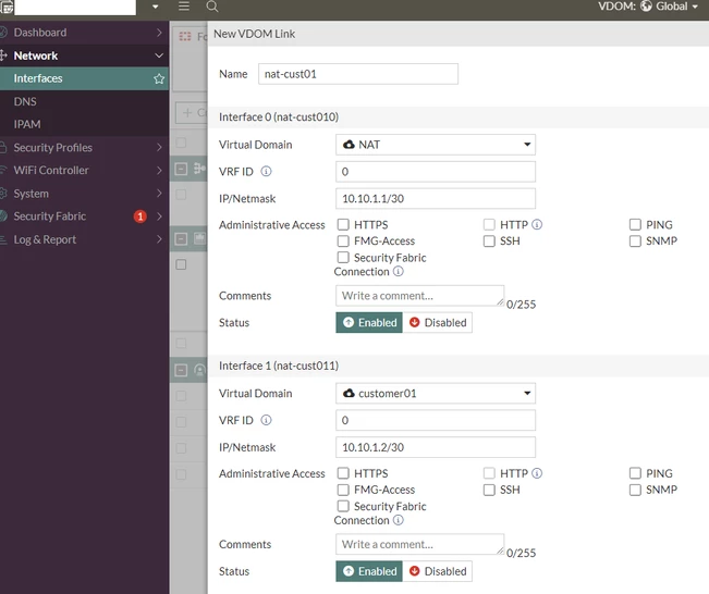

  1. On the Global VDOM, for each pair of NAT-Customer VDOMs, configure a /30 inter-VDOM-link.
inter-vdom linkinter-vdom link
See Configure Inter-VDOM link.
Alternatively, a hardware accelerated vdom-link can be used: Configuring Inter-VDOM link acceleration.

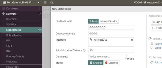

  1. Configure a default route in the Customer VDOM:
customer default routecustomer default route

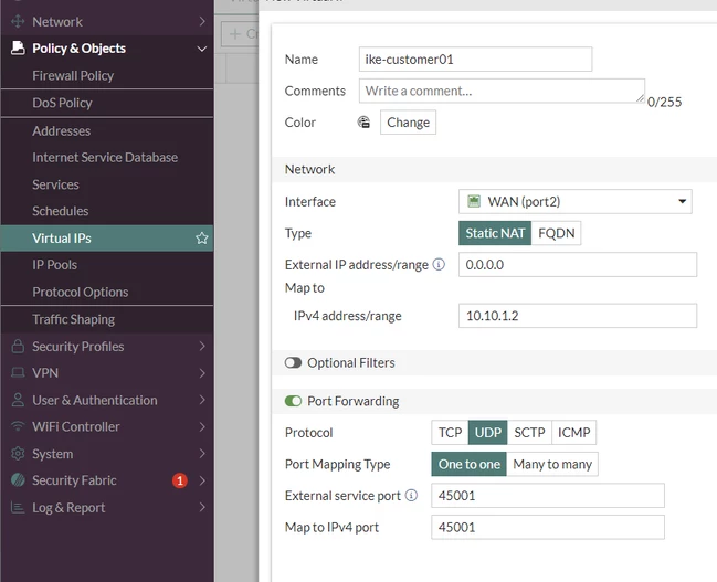

  1. On the NAT VDOM, create a VIP with port forward for each customer using the IKE port.
VIP IKE port forwardVIP IKE port forward
Reference: Virtual IP with services.

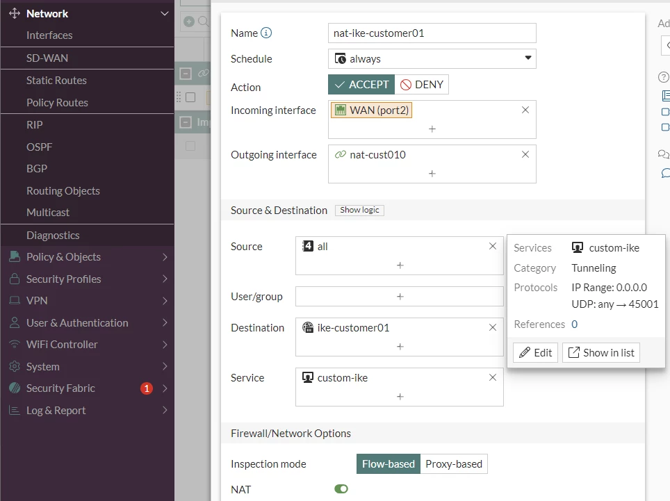

  1. On the NAT VDOM, configure a DNAT policy using the previously created VIP.
DNAT PolicyDNAT Policy
