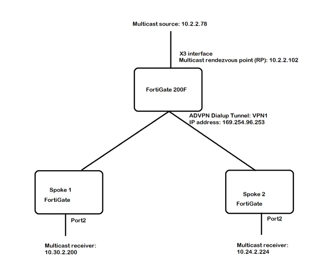

In the standard ADVPN hub-and-spoke topology described below, multicast PIM-SM (PIMv3) is enabled on the hub and both spokes.
The hub FortiGate 200F interface x3, which serves as the gateway for the multicast source, is configured as the multicast Rendezvous Point (RP). The hub forwards multicast traffic from the source to all spokes based on the multicast routing table.
BGP peering is established between the hub and spokes over the IPsec tunnel VPN1, allowing each spoke to learn the unicast route toward both the multicast source and the RP.

Despite correct multicast routing state on both the hub and spokes, packet captures reveal that only one spoke receives continuous multicast traffic at any given time.
For example, in below packet capture below, Spoke 1 receives only the first two multicast packets and then stops. Spoke 2 continues to receive multicast packets without interruption. If multicast traffic stops and restarts, the issue may switch to the other spoke.
