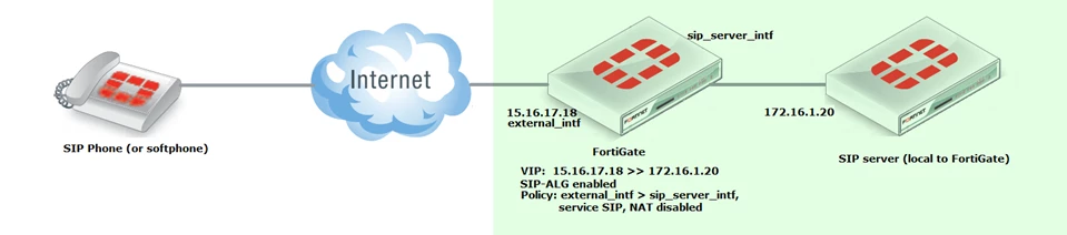

 The SIP server (managed by user) is in a private network, protected from the internet by a FortiGate (managed by user).
  • Phones need to register to the SIP server, in order to place calls through it. So port 5060 needs to be open through FortiGate by a VIP.
VIP can open port 5060 or all ports, and only one firewall policy is needed, external_intf>sip_server_intf, service SIP, NAT disabled.
Based on the SDP information in the SIP packets, the FortiGate will open the necessary audio ports for each session.

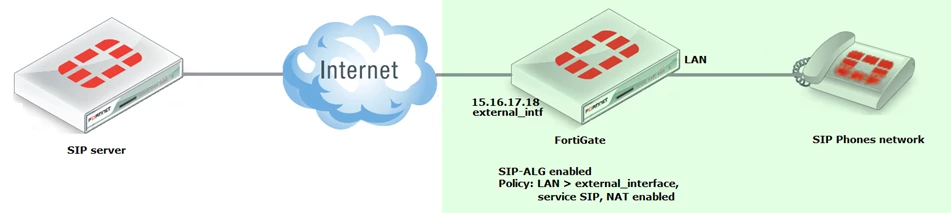

The SIP clients (managed by user) are in a private network, protected from the internet by a FortiGate (managed by user).
  • FortiGate must apply Source-NAT to the outgoing packets, including the SDP content, to hide the internal network.
By default, SIP-ALG does this with no further configuration other than a firewall policy: LAN ->external_interface, service SIP, NAT enabled.
Based on the SDP content a new session expectation -for RTP- is created).

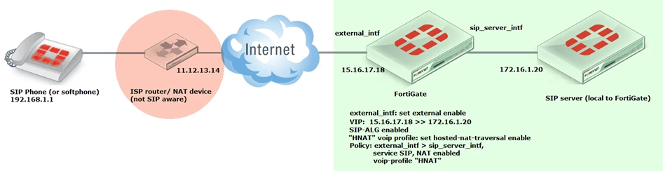

The SIP clients are in a remote private network, such as a SOHO network, AND behind a NAT device that is not aware of SIP applications.
  • The NAT will only change the content of the IP headers, leaving the SDP content (IPs) unchanged. This causes problems in the SIP process.
FortiGate must have HNAT enabled to correct this situation:
'set external enable' on the incoming interface, VIP to open the port 5060 to the local SIP server,
'hosted-nat-traversal' must be enabled on the voip profile, VIP as dest object + NAT enabled in policy.

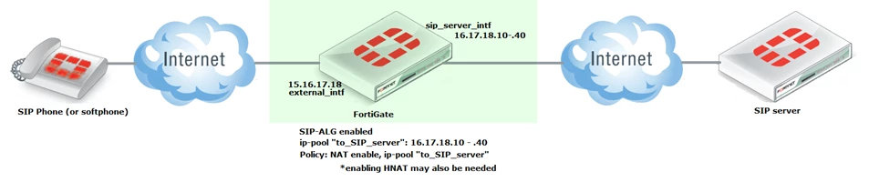

The SIP clients are in a remote public network; SIP server is located in a different public network.
SIP clients may or may not be behind a SIP-aware NAT unit.
SIP server accepts incoming connections only from a specific range of IPs, so FortiGate must NAT the traffic to the desired range by using an IP-pool.
Neither the clients, nor the server is on the local/private network.
