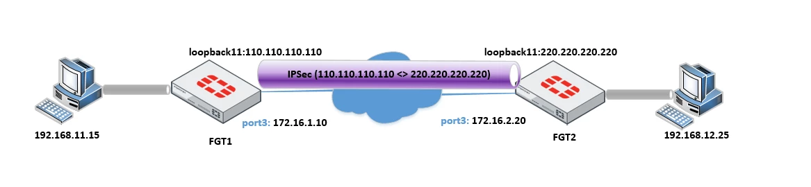

Topology and Prerequisite
-> FGT1 and FGT2 have an IPsec tunnel (named VPN11) between loopback11 interfaces 110.110.110.110 and 220.220.220.220 respectively.
-> FGT1 has static route for 220.220.220.220 via 172.16.1.11 (next-hop router via port3).
-> FGT2 has static route for 110.110.110.110 via 172.16.2.11 (next-hop router via port3).
-> Both, FGT1 and FGT2 have 'set dpd on-idle' (trigger Dead Peer Detection when IPsec is idle).
-> FGT1 does not have 'set local-gw' (this requirement is not enforced by the CLI) while FGT2 has correctly configured local-gw (220.220.220.220).
