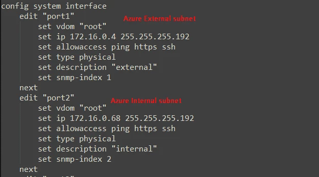

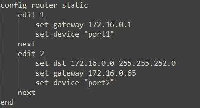

  3. Ensure edit the following attribute to reflect the correct interface and routing information in the cloud environment:
    1. config system interface.
    2. config router static.

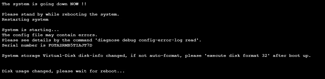

  2. During the restoration, Azure FortiGate would detect changes in virtual disk usage. FortiGate will perform auto-format and proceed to reboot once again:

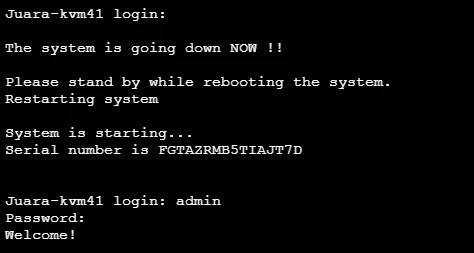

  3. Log in with the existing login credential on the on-prem FortiGate VM if the admin has not been changed:
