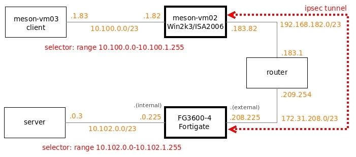

Purpose
The purpose of this technical note is to provide a simple example of an IPSec tunnel between a Microsoft ISA server 2006 running on a Microsoft Server 2003 system and a FortiGate firewall.  FortiGate configuration samples are provided for 4.1.9 (4.0 MR1 patch 9)  and 4.2.3 (4.0 MR2 patch) releases.
Although the document was written for 4.1/4.2, it also applies for 4.3/5.0 releases.
This example does not aim to provide the best security configuration but rather a simple configuration base.  Security enforcements can easily done as a second stage to implement tighter policies.

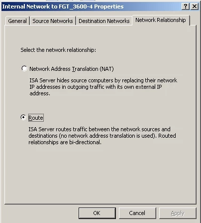

Microsoft ISA server 2006, VPN IPSec, no natting, no proxying.
FortiGate using IPSec interface mode (but policy mode is also possible)
Diagram

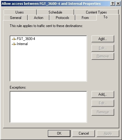

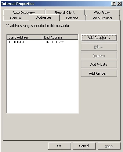

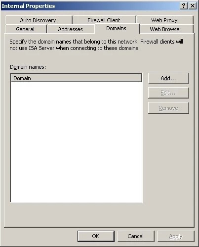

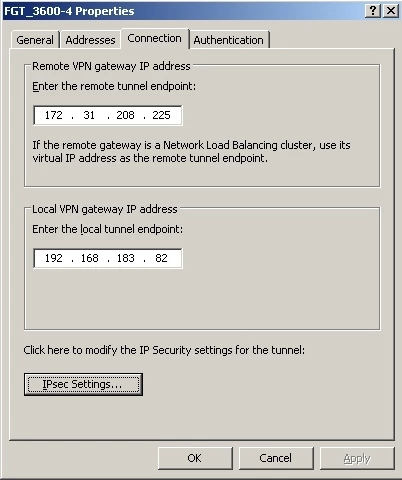

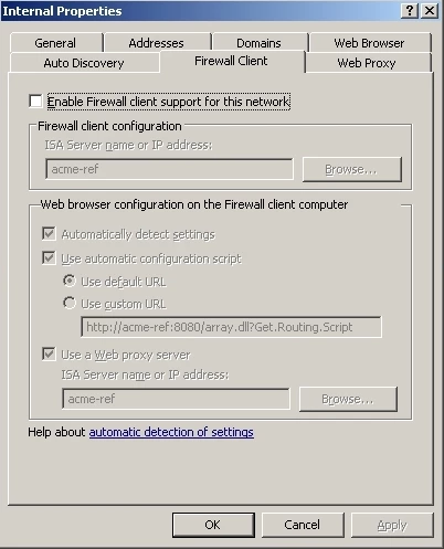

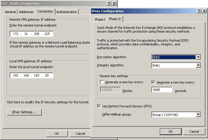

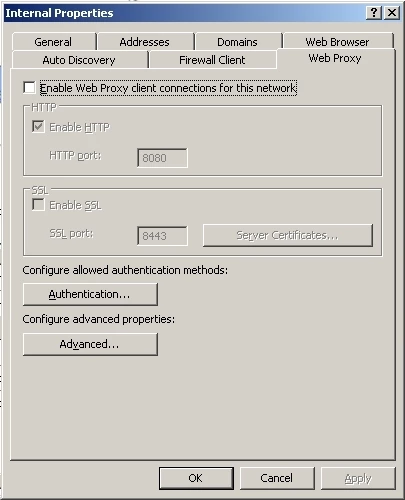

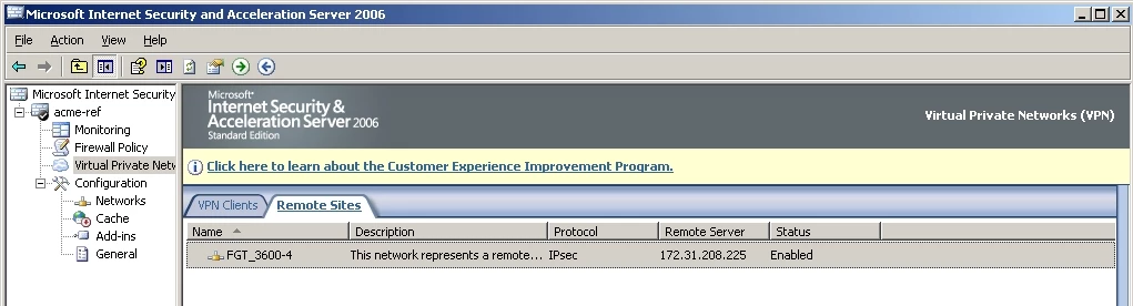

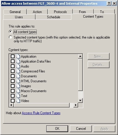

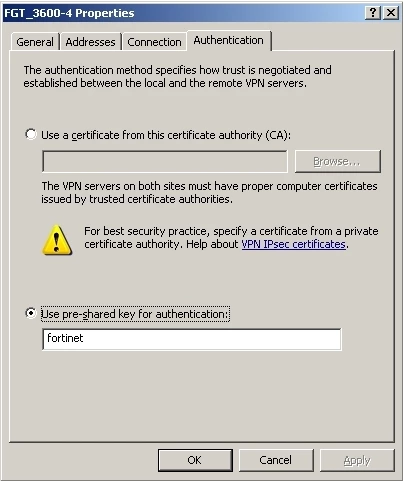

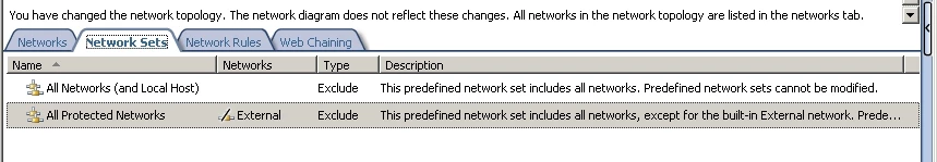

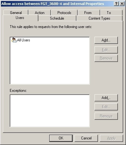

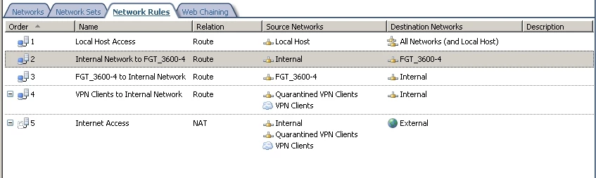

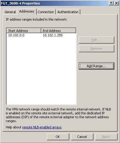

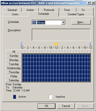

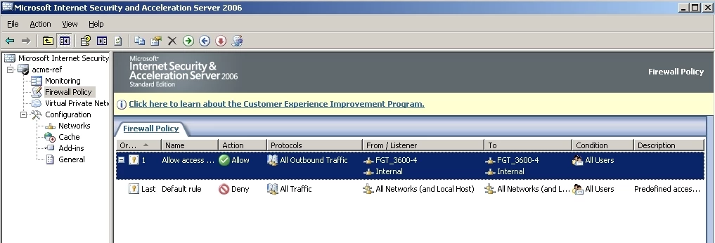

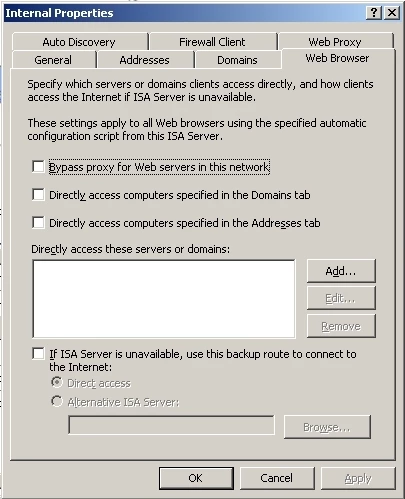

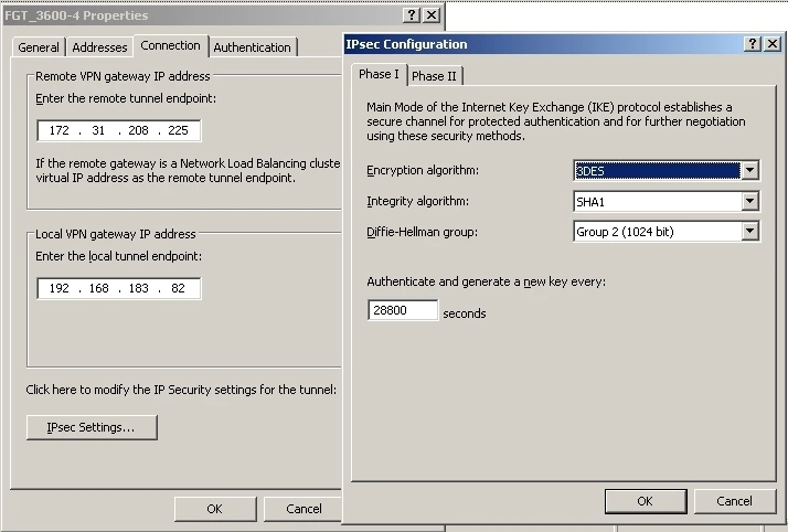

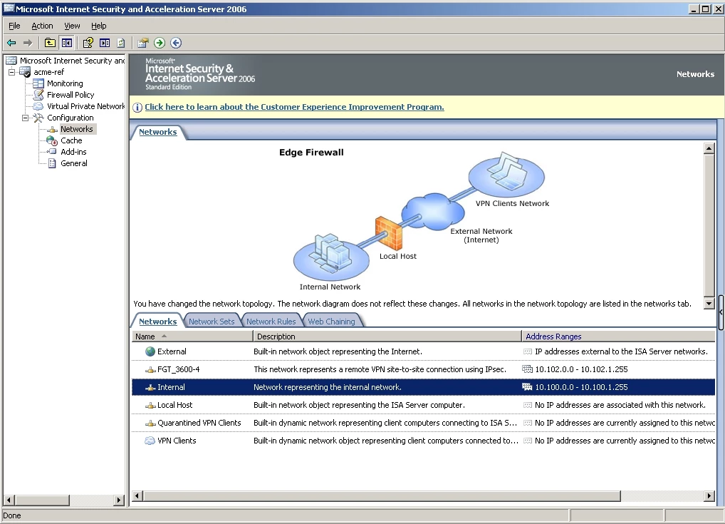

Microsoft ISA server configuration:
cgustave_33079_VPN_remote_sites_general.jpgcgustave_33079_VPN_remote_sites_Addresses.jpgcgustave_33079_VPN_remote_sites_connection.jpgcgustave_33079_VPN_remote_sites_connection_Phase1.jpgcgustave_33079_VPN_remote_sites_connection_Phase2.jpgcgustave_33079_VPN_remote_sites_authentication.jpg

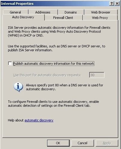

cgustave_33079_config_networks_internal_general.jpgcgustave_33079_config_networks_internal_addresses.jpgcgustave_33079_config_networks_internal_domains.jpgcgustave_33079_config_networks_internal_webbrowser.jpgcgustave_33079_config_networks_internal_autodiscovery.jpgcgustave_33079_config_networks_internal_firewallclients.jpgcgustave_33079_config_networks_internal_Webproxy.jpg
cgustave_33079_config_network_network_set.jpgcgustave_33079_config_network_network_rules.jpgcgustave_33079_config_networks_network_rules_Networkrelationship.jpg

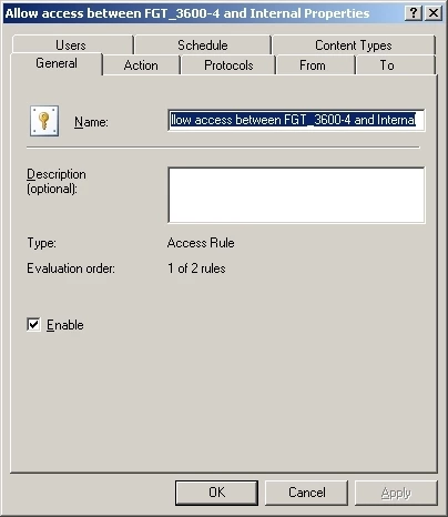

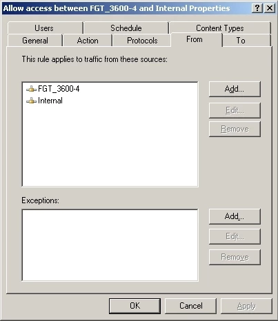

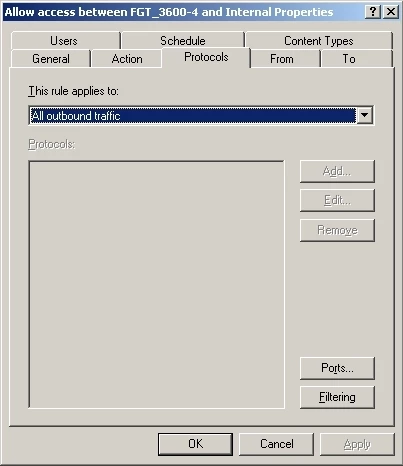

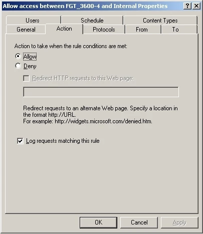

cgustave_33079_firewall_policy_general.jpgcgustave_33079_firewall_policy_action.jpgcgustave_33079_firewall_policy_protocol.jpgcgustave_33079_firewall_policy_from.jpgcgustave_33079_firewall_policy_to.jpgcgustave_33079_firewall_policy_users.jpgcgustave_33079_firewall_policy_Schedule.jpgcgustave_33079_firewall_policy_contenttype.jpg

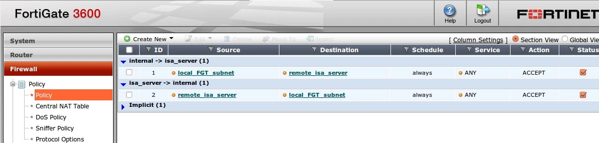

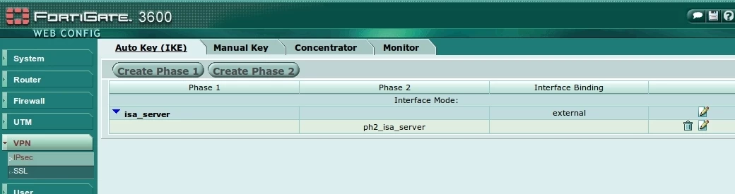

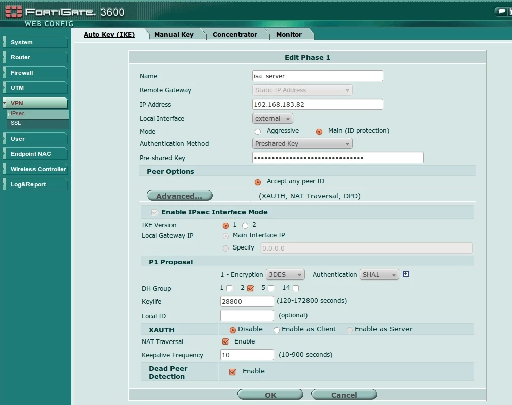

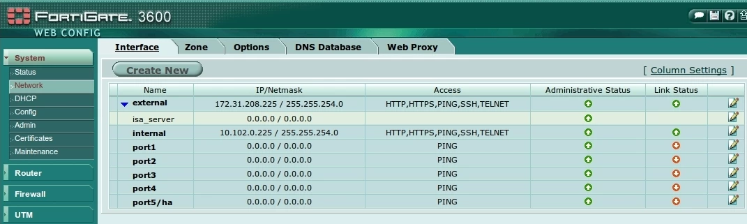

FortiGate 4.1.9 configuration:

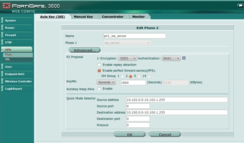

Phase 1:

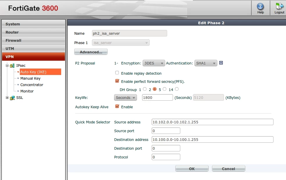

Phase 2:

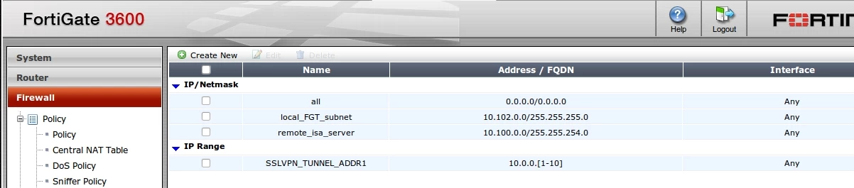

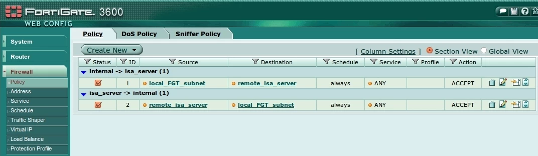

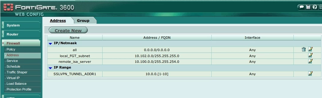

Firewall Addresses:
Firewall Policies:

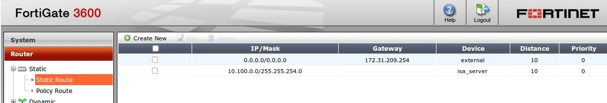

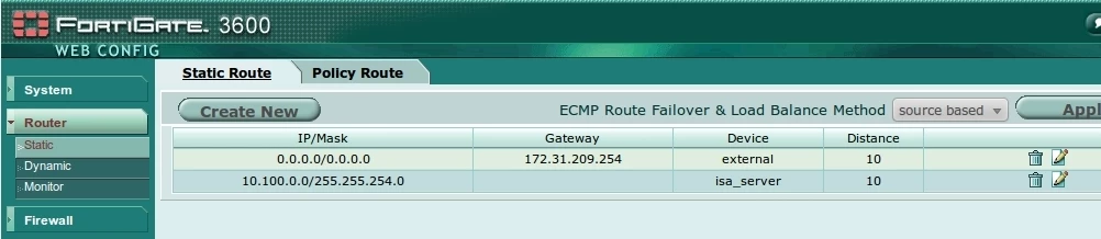

VPN route:

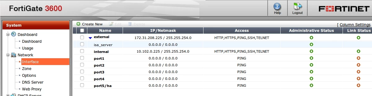

Interfaces summary:

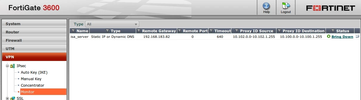

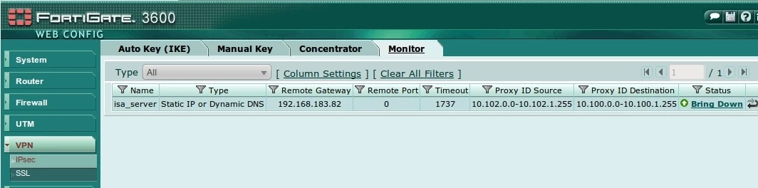

IPSec Monitoring:

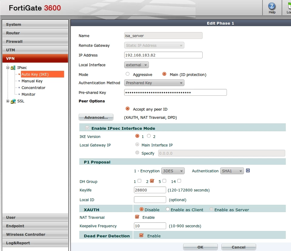

FortiGate 4.2 configuration:
Phase1:
Phase2:
Firewall Address:
Firewall Policies:
VPN Route:
Interfaces Summary:
IPSec monitor:

  • ISA Server phase2 selector and IP ranges:
ISA server (in the version tested) only supports well subnet ranges starting from network address to broadcast. You should be using local range or distant range such as 10.100.0.0-10.100.0.255. Attempt to use 10.100.0.1-10.100.0.254 for instance would cause the ISA server to present unexpected phase2 selectors ending in selector mismatch. FortiGate 'diag debug application ike -1' debug output shows the selector send from the peer.
