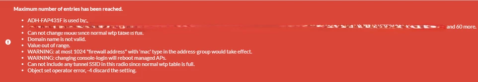

Administrators may encounter the 'Maximum number of entries has been reached' or 'Normal WTP table is full' error when attempting to add an SSID to an AP/Operation profile. This failure is typically triggered by reaching a predefined table size limit for the amount of manageable AP's.

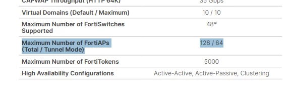

  • Consult the Max Value Table or the model's official datasheet.
  • Use the 'print tablesize' or 'diagnose wireless-controller wlac tablesize' command and check the limit for wireless-controller-controller.wtp
    • This command will show the total manageable AP limit ,  as a rule of thumb Tunnel-mode AP limits are half of the total size of manageable AP's.

Consider a deployment with 93 active FortiAPs, each broadcasting a mix of six SSIDs, five in Bridge mode and one SSID in Tunnel mode. While a model like the FortiGate 120G supports up to 128 total Access Points, it is strictly limited to a maximum of 64 FortiAPs in Tunnel mode.
Because this deployment attempts to broadcast a tunneled SSID across all 93 units, it exceeds the 64-AP tunnel limit. Consequently, the hardware cannot establish the required CAPWAP tunnels for the remaining 29 units, leading to 'Maximum Number of Entries Reached' Error.
