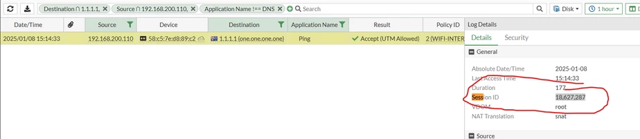

The session ID can be checked in the Traffic Log -> Log Details:

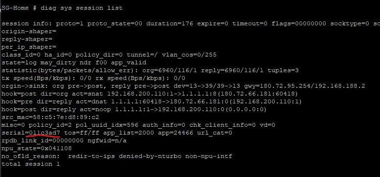

In the output of the 'diag sys session list', the session ID is the 'serial':

To confirm both are the same session, a scientific calculator is required to do a hexa and dec conversion:
Based on the calculator output above, 11c3ad7 and 18627287 matched. Therefore, there are the same sessions.
