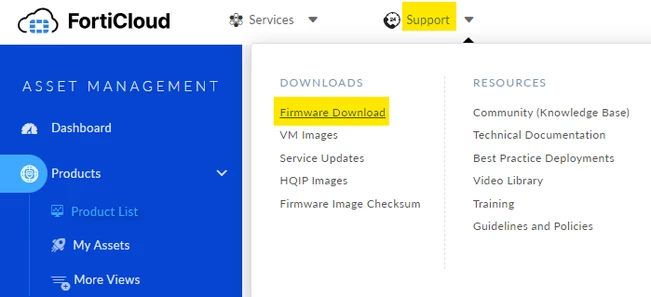

  1. Log in to Welcome to Fortinet Support.
  2. Go to Support -> Firmware Download.

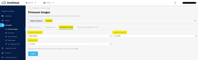

  1. Select the appropriate product: FortiGate -> Upgrade Path.
  1. Select the product model (Current Product).
  2. Select the current device firmware version and upgrade to the firmware version details.
To check the upgrade path for firmware v5.2.9, see the related article links shared at the end of this article.

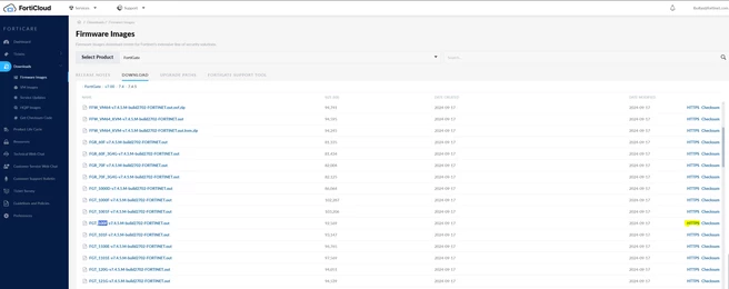

To download the image files from Welcome to Fortinet Support, navigate to Support -> Firmware Download, select Product: FortiGate, and Download.
Navigate to the required firmware version, locate the image file, and select HTTPS as in the example below. Note that 'pop-ups' must be allowed on the web browser for the HTTPS button to work.
Example: FortiGate 100F.
The file name starts with FGT_100F.
Select 'HTTPS' to start the download.

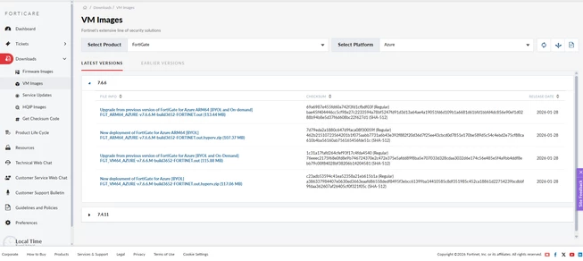

To download the Latest VM image files from Welcome to Fortinet Support, navigate to Support -> VM Images, then select Product and Platform.

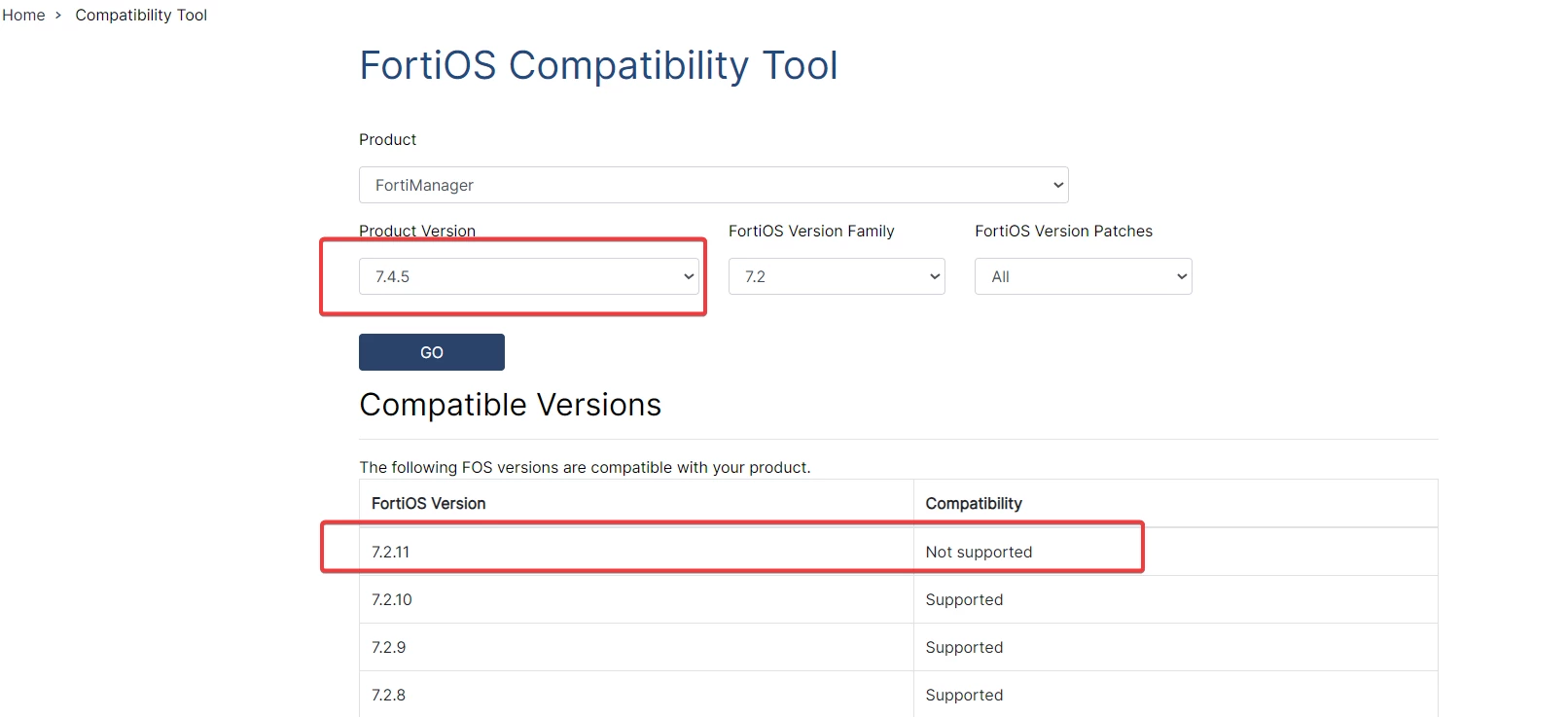

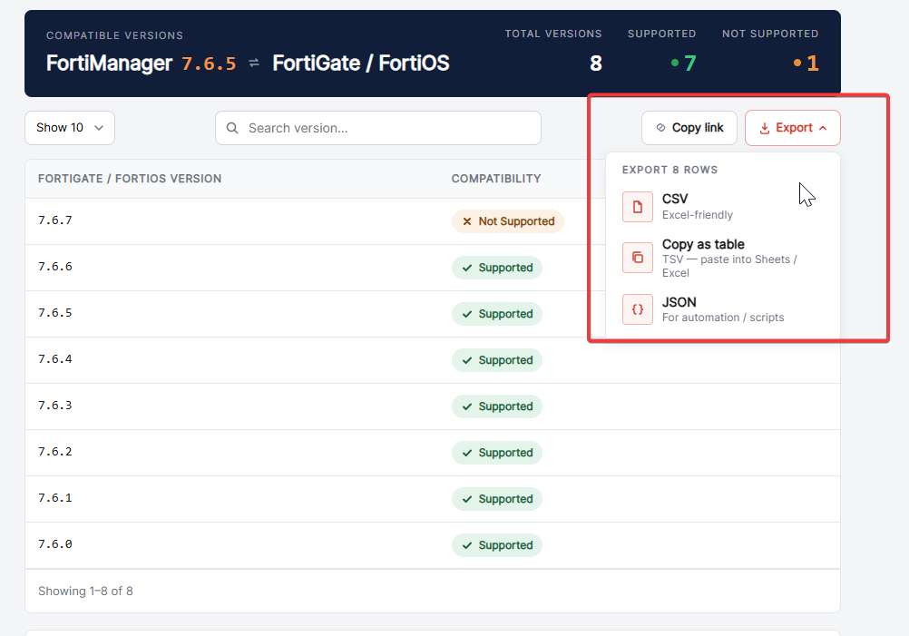

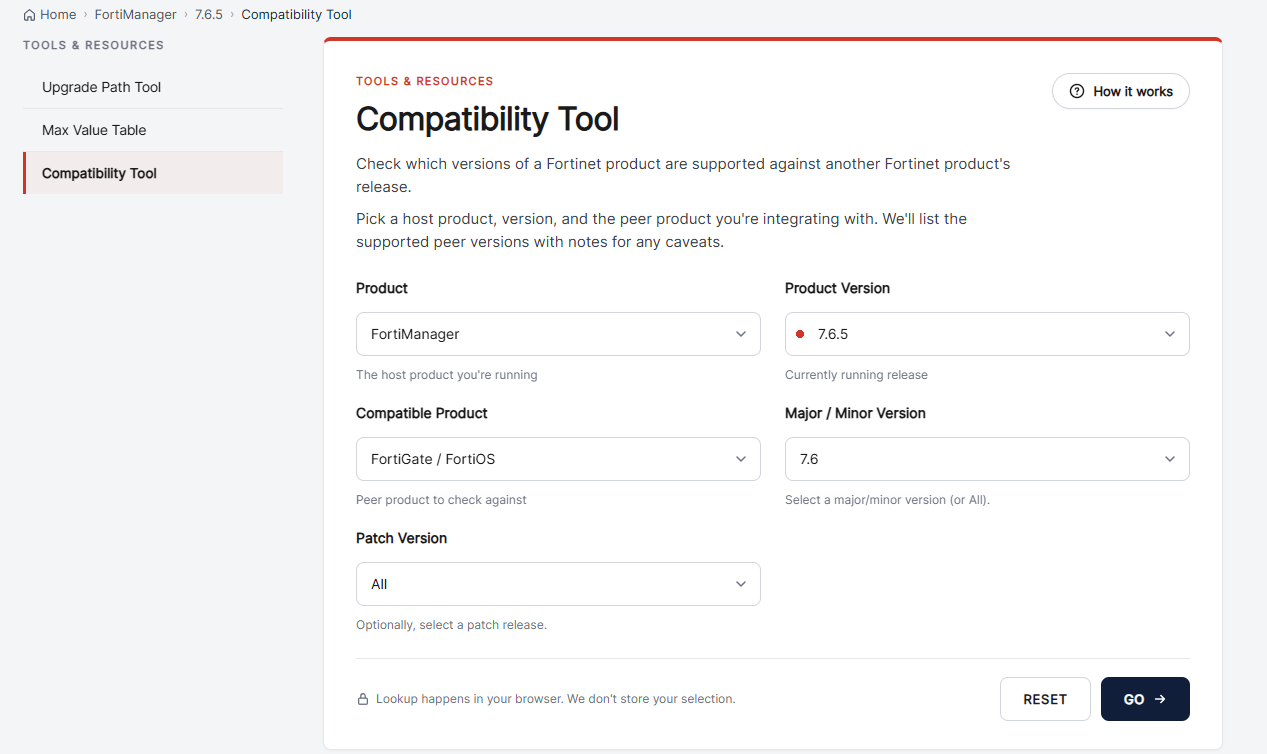

If the FortiGate is managed by FortiManager, check the firmware compatibility between the FortiGate and FortiManager before performing the upgrade:
Example: If FortiGate is scheduled to upgrade to v7.6.x and the FortiManager v7.6.5 is on firmware version from the screenshot below, view all compatible versions of FortiOS.
Results: With the exception of FortiOS v7.6.7, all FortiOS versions from v7.6.0 to v7.6.6 are supported. To export the results in spreadsheet format, choose the CSV option or Copy as table. Using the 'Copy link' option will save the results.

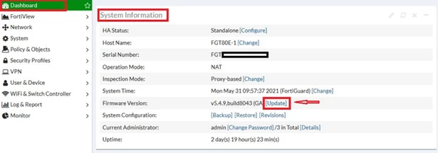

To upgrade the firmware in the FortiOS v5.4.x GUI:
  1. Log in to the FortiGate GUI as the administrator user.
  2. Go to Dashboard -> System Information.
  3. Select 'Update' before ‘Firmware Version’, then select Browse and locate the previously downloaded firmware image file.
Select Backup config and upgrade.

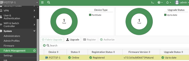

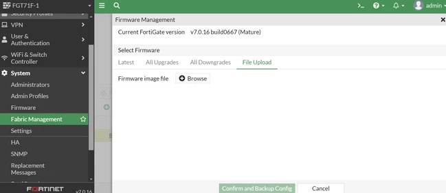

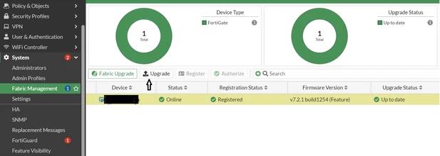

Upgrade the firmware from GUI v7.0.x, v7.2.x, and v7.4.x:
  2. Go to System -> Fabric Management (v7.0.x/v7.2.x) or Firmware & Registration (v7.4.x).

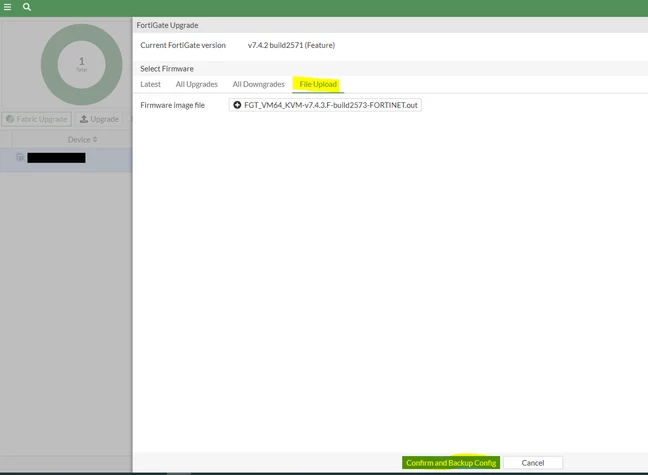

  3. Choose the FortiGate, select Upgrade, select File Upload, select Browse, and locate the previously downloaded firmware image file.
  4. Select Confirm and Backup Config.

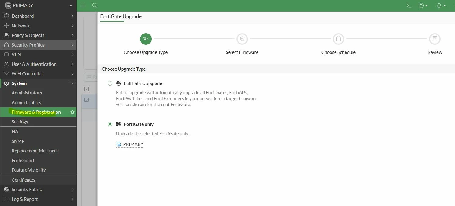

  2. Go to System -> Firmware & Registration.
  3. Choose the FortiGate, select Upgrade, select FortiGate Only, and select Next.
  4. Select File Upload, locate the previously downloaded firmware image file, and select Next.
  5. In Upgrade Schedule, select Immediate, select Next, select Confirm and Backup Config.

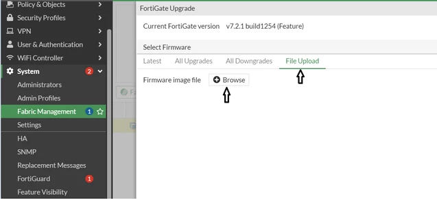

  • Starting from v7.0.6, to upgrade firmware from the GUI: Go to System -> Fabric Management, select the FortiGate, and select Upgrade. The FortiGate Upgrade pane opens and provides an option for selecting the firmware.

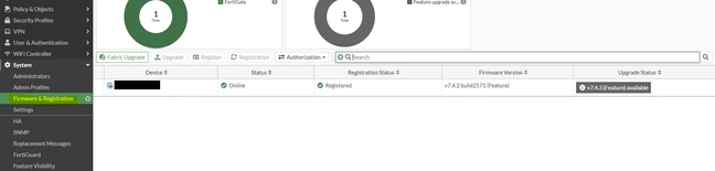

  • For v7.4.x, firmware upgrade under System -> Firmware & Registration.
  • View the screenshots below for more information on the upgrade procedure in v7.4.x.
  • Go to System -> Firmware & Registration.
  • Select the Device and select Upgrade.
  • Select the file upload option and add the appropriate firmware image downloaded from Welcome to Fortinet Support.
