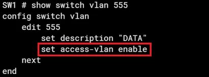

FortiSwitch:
  • 'access-vlan enable' (CLI).

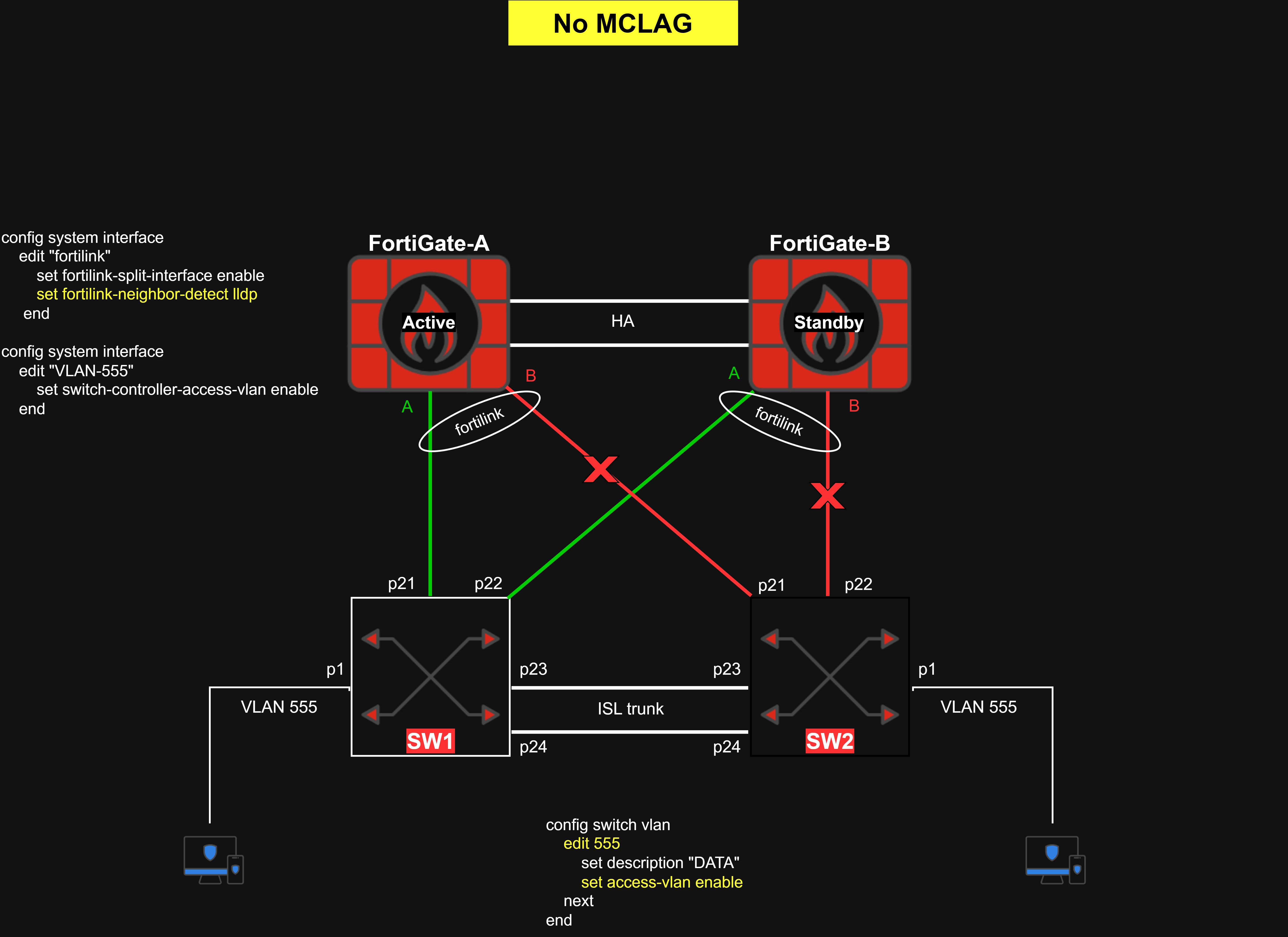

In cases where both of the conditions are met, change the following setting on the FortiGate managing the switches:
config system interface
    edit fortilink
        set fortilink-neighbor-detect fortilink
This is because, starting from FortiOS 7.6.1, the default 'fortilink-neighbor-detect' is updated to LLDP instead.
If the detect mode will be left on LLDP (the new default) with ring topologies/no MCLAG and with the default 'fortilink-split-interface' enabled (as it should with ring topologies) will have an impact on any VLANs configured to block intra-VLAN traffic if a failover event occurs.
The failover can either be for the existing FortiGate FortiLink members, resulting in a new member actively forwarding traffic, or a complete switch failure/shutdown/disconnection.
Consider the following topology example illustrating the issue:
