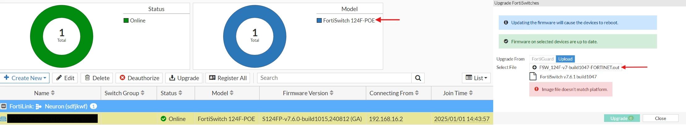

This article describes how to debug managed FortiSwitch firmware upgrade 'Image file doesn't match platform' error on FortiGate as shown below:
FortiGate.

  3. Verify the hardware model and the image match. For example, in this case, the hardware model is 124F-POE but the image is for the regular model.
