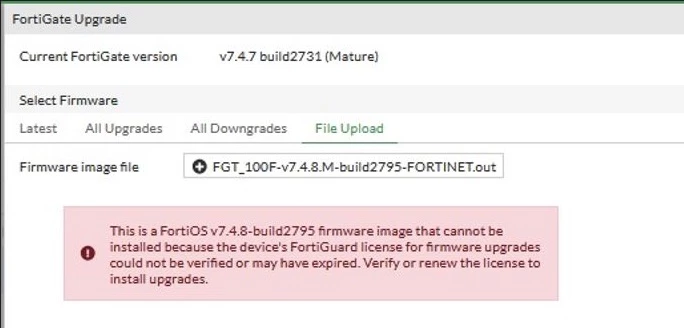

Note: If the FortiGate can not be upgraded to the fixed FortiOS version due to a license issue, as shown in the screenshot below. Follow the steps below the image to solve it.
  1. Disassociate the FortiGate from the VSN SN. It looks like this: FG100FHA250. From the FortiCloud portal, use the 'Dismiss HA' button to try to remove the VSN or, if needed, open a ticket with customer services, who will help to de-register the FortiGate in question. See FortiCare technical support.
  2. Upgrade the firmware to the GA build, which has the fix, and ensure that the logical-sn is properly configured under the HA setting.
  3. Generate an HA cluster using a preregistered FortiGate serial number as per the document: Generating an HA cluster.
