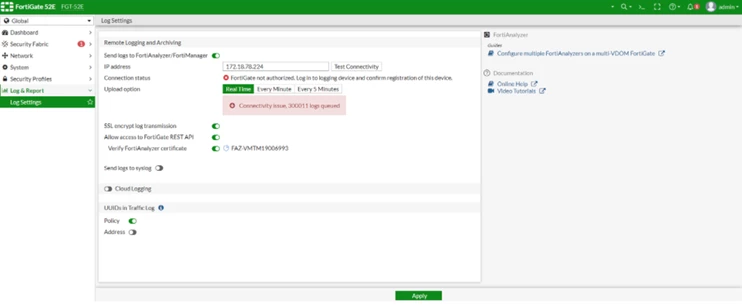

FortiGates with a SSD disk have a configurable log buffer.
When the connection to FortiAnalyzer is unreachable, the FortiGate is able to buffer logs on disk if the memory log buffer is full.
The logs queued on the disk buffer can be sent successfully once the connection to FortiAnalyzer is restored.
The number of logs queued on the disk buffer is visible under Log & Report -> Log Settings page:

The queued logs are buffered to the memory first and then disk. Main miglogd handles the disk buffering job, while miglogd-children handles the memory buffering. Disk buffer statistics only appear under Main miglogd, and memory buffer statistics only appears under miglogd-children. If the total buffer is full, new logs will overwrite the old logs.

For example, delete the FortiGate from the FortiAnalyzer authorized unit list.
Assuming a massive number of logs (~ 300000) are recorded during this downtime, the logs will be queued in the memory buffer first.
If the memory buffer is full, then the remaining logs will be queued on the disk buffer.
Check the Main miglogd and miglogd-children statistics again.
All 97 MB of the memory buffer is occupied, and 76 of the 200 MB has been taken from the disk buffer:
