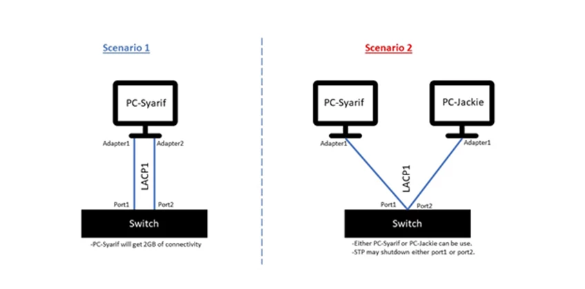

Scenario 1.
On the switch.
  • Port1 and Port2 are configured as LACP group 1.
  • Port1 and Port2 connect to PC-Syarif. IP address 192.168.1.254.
If the connected interfaces are 1 Gbps, this makes the potential bandwidth for PC-Syarif 2 Gbps.
Scenario 2.
On the switch.
  • Port1 connects to PC-Syarif. IP address 192.168.1.254.
  • Port2 connects to PC-Jackie. IP address 192.168.1.253.
Refer to the diagram below:
It is not possible for a single 'cable' to connect to two PCs at the same time. PC-Syarif and PC-Jackie are individual devices. This scenario will not work as LACP cannot be connected to multiple devices at the same time, because it is acting as a single physical connection.  Either Port1 or Port2 will be shut down. This is to mitigate ARP conflict, broadcast issues, and so on.  The individual devices, PC-Syarif and PC-Jackie, will not notice that the traffic will be flowing or notice that the physical cable on the adapter is showing as not connected.
