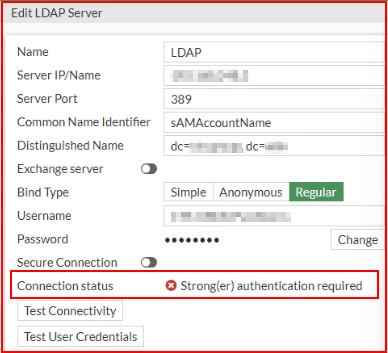

This article describes how to fix the LDAP connection status 'Strong(er) authentication required'.
Under Users & Authentication -> LDAP Servers, 'double-click' on the LDAP server name, and the connection status is shown below:
Based on the fnbamd debug logs:
2023-08-14 16:06:10 [987] fnbamd_ldap_parse_response-Got one MESSAGE. ID:1, type:bind
2023-08-14 16:06:10 [1009] fnbamd_ldap_parse_response-Error 8(00002028: LdapErr: DS
ID-0C090276, comment: The server requires binds to turn on integrity checking if SSL\TLS are not already active on the connection, data 0, v2580) ---> Error sent by LDAP Server
2023-08-14 16:06:10 [1023] fnbamd_ldap_parse_response-ret=8
2023-08-14 16:06:10 [785] __ldap_done-svr 'Forti-LDAP'
2023-08-14 16:06:10 [755] __ldap_destroy-
2023-08-14 16:06:10 [724] __ldap_stop-Conn with 192.168.xxx.xxx destroyed.
2023-08-14 16:06:10 [216] fnbamd_comm_send_result-Sending result 1 (nid 0) for req1885254761, len=2148
2023-08-14 16:06:10 [789] destroy_auth_session-delete session 1885254761
authenticate 'it-administrator' against 'Forti-LDAP' failed!
Scope FortiGate.

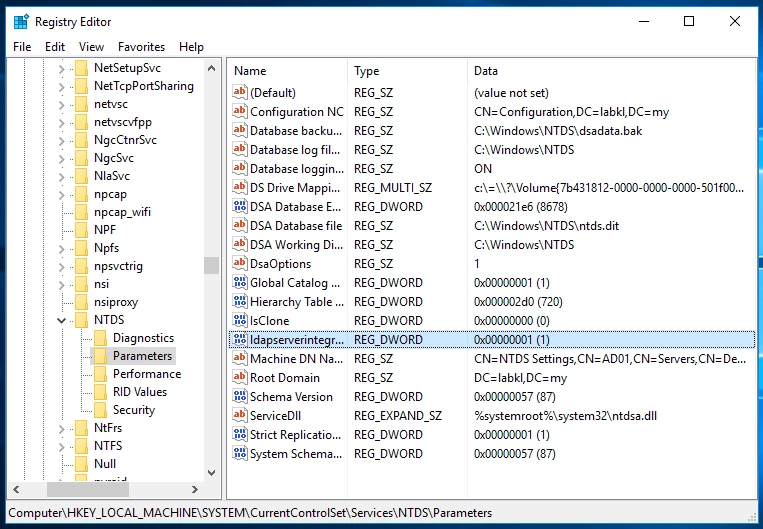

It is required to change the value of the parameter 'ldapserverintegrity' on the LDAP server, which must be equal to '0' or '1' when Secure Connection is disabled in the FortiGate
  1. Locate and then select the following registry subkey: HKEY_LOCAL_MACHINE\SYSTEM\CurrentControlSet\Services\NTDS\Parameters.
  2. 'Right-click' the LDAPServerIntegrity registry entry, and then select 'Modify'.
  3. Change Value data to 0 or 1 (default is 2 depends on Windows OS)
  4. Select 'OK'.
The registry entry has the following possible values:
  • 0: Signing is disabled.
  • 1: Signing is negotiated if supported by both Client and Server.
  • 2: Signing is mandatory.
This is a change on the domain controller unrelated to FortiGate. This change would fix the error message sent by the domain controller.
Since the domain controller, in its role as a server, sends the message to the FortiGate in its role as a requesting client, the reason for the response the server sends must be looked at on the server, not the FortiGate.
Contact the server team handling the domain controller or LDAP server with the recommendation above. There may be a reason that the registry setting is set to what it is. If so, another solution must be found by the team.

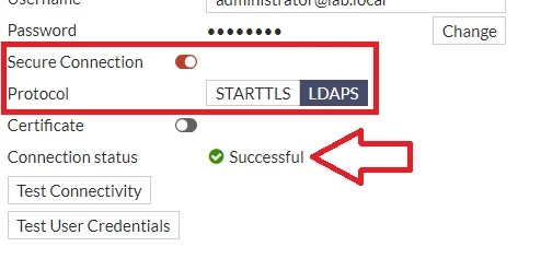

In case of the requirement to have this parameter active, as Microsoft Document advises, it is required to have Secure Connection enabled and LDAPS configured:

Additionally, GPO policies can also override what's discussed in the KB. Therefore, you need to check HKLM\SYSTEM\CurrentControlSet\Services\NTDS\Parameters\ldapserverintegrity showed a value of 1
Although the registry key HKLM\SYSTEM\CurrentControlSet\Services\NTDS\Parameters\ldapserverintegrity showed a value of 1, in my case the DC was still rejecting connections because Windows Server 2025 introduces a second policy called Domain controller: LDAP server signing requirements Enforcement that overrides the default behavior.
On the DC, gpmc.msc was opened and the Default Domain Controllers Policy was located. Inside the GPO editor, the following path was followed: Computer Configuration -> Windows Settings -> Security Settings -> Local Policies -> Security Options. Two policies were modified: Domain controller: LDAP server signing requirements was set to None, and Domain controller: LDAP server signing requirements Enforcement was set to Disabled.
The command gpupdate /force was then executed to apply the changes immediately.
