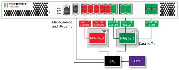

FGT900D # diagnose npu np6 port-listThe below diagram shows the connections between the two NP6Lite processors on FortiGate-200E.

As this model does not include a switch fabric, LAGs cannot be created between interfaces connected to different NP6Lites.
Traffic will only be offloaded if it enters and exits the FortiGate.
